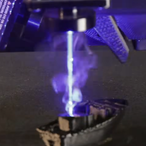

Now, not everyone minds the characteristic layer lines you get with Filament Deposition Modeling (FDM) 3D prints, but sometimes you need a smooth surface. If so we might go for filling primer, Bondo, or maybe break out the ABS and vapor smooth. Well, [I changed a thing] has an alternate suggestion: lasers. Laser melting can smooth the walls on a print, or the top surfaces as he shows in two different videos, both embedded below. The results look roughly similar to vapor smoothing, without the chemical exposure small risk of explosion.
Of course, you need a laser to do this, and [I changed a thing] has two diode lasers mounted to the X-axis of his printer. Of the two, the top surfaces were a lot easier to get right than the wall smoothing, which makes sense. Top surfaces are right there for the laser to get at, after all, while with his laser setup [I changed a thing] needs to get at the walls obliquely. [I changed a thing] tries melting layer-by-layer as well as a few methods to get at the walls of a finished print; which works best seems to depend on the size of and geometry of the object, so it looks like this technique is as much art as science right now.
This effort is closely related to the previous work [I changed a thing] did on improving layer adhesion with laser melting.  It’s also not the first time we’ve seen laser-driven print smoothing, but that project used non-planar movements to do a post-print laser pass.

    1. Wonder if it’s so wobbly due to all the extra hardware they’re hanging off of the carriage? Maybe mount the lasers remotely use some fibre optics to get the light where it’s needed. A belt re-tension might help too.
    2. That’s what I was thinking. At least needs a tune-up… Those are some extremely nasty layers. I agree with the others here, it’s probably due to way too much mass on the print head and is being treated as an acceptable drawback only for the experimentation phase of this project
  1. I am wondering, wouldn’t stationary lasers, each with an optical fibre going from it to the print head be a possibility? That would significantly reduce the weight that has to be lugged around during printing,

    1. good point, but although you wouldn’t mind layer lines, you may mind wrinkles, which is exactly what this laser setup seems to create. All I can think of, is ditch the dangerous and costly lasers, switch to ABS and put the printed object in an acetone bath or vapor chamber.

    1. Not according to measurements in the previous article covering this machine. The gain in z-axis adhesion is pretty impressive. And I think eventually the lasers will be relocated with fiber or mirrors delivering the photons with much less print head inertia.
      Here’s the other article. Big double-digit increases for ABS and PLA, up to 94% compared to the part strength in other axes… nothing to scoff at imho:
