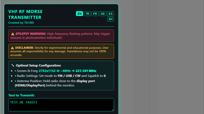

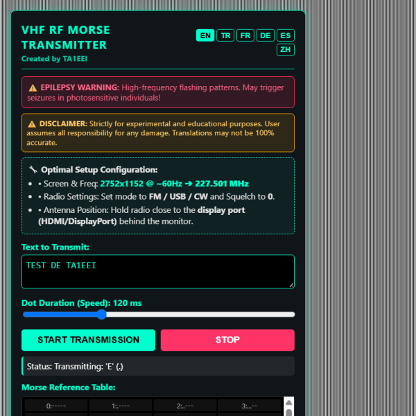

If you’re intending to transmit on the VHF band, you’re probably going to reach for a handheld or some kind of rackmount rig in your ham shack. But you needn’t bother with all that complexity, when you can use the computer on your desk to spit out such signals using a simple browser tool from [Efe].
The concept is straightforward—[Efe]’s tool manipulates pixel clocks in order to create spurious transmissions from your computer’s graphics hardware. The math pencils out pretty easily—multiply the horizontal resolution by the vertical resolution by the refresh rate, while paying attention to the precise timing of the video standard your monitor is using, and you’ve got your transmission frequency. For example, for a screen displaying 1080p at 60 Hz, with the CEA-861 timing standard, your horizontal and vertical resolutions are 2200 and 1125 respectively when paying attention to the requisite blanking intervals. Multiply those by 60 hz, and you’ll find you’re creating a signal at 148.500 MHz. Leverage this by displaying the right pattern of black and white pixels to maximise changes in voltage state on the HDMI or DisplayPort lines, and you might create a strong enough signal that you can actually pick something up. [Efe] created a tool to display these patterns to send simple Morse code messages over VHF just by flickering your screen just right.
You can test the transmitter tool for yourself here, right in your browser. You’ll want to hold your radio’s antenna nice and close to the monitor to see if you can pick up much of a signal. After all, the monitor, connectors, and cable are all built to optimize for clear signal transmission to the display, while preventing signal from leaking out to interfere with surrounding equipment.
Of course, a fair warning—you’re not supposed to intentionally transmit on bands you’re not licensed for, even if it’s incredibly weak and unlikely for anyone else to notice in a scenario like this. Still, it’s an interesting project that shows you just how electromagnetic interference can leak out of just about anything under the right conditions.

I love the disclaimer at the end. It’s the preemptive strike of the ham world.
Actually I only leveraged AI for the UI. I wrote the core project myself but it didn’t look very nice so I got help from Gemini. However, it suggested ‘Hey, it would be better if I fixed these areas’ and I didn’t argue

How does this get around the TMDS bit encoding trying to keep the number of transitions relatively constant?
Author here! That’s a really great question. To be completely honest, I actually stumbled upon this somewhat by accident while tinkering around and noticing my radio picking up weird RF spikes from screen patterns.
Technically, while TMDS 8b/10b encoding minimizes intra-word transitions and keeps DC balance, the mapping is strictly deterministic. By rendering alternating spatial patterns (e.g. repeating high-contrast pixel strips across the canvas), we force repetitive 10-bit codewords at predictable intervals.
This generates a massive, coherent RF spike at specific subharmonics/multiples of the pixel clock and line frequency. When switching back to a flat solid background, that spectral peak collapseseffectively giving us clean On-Off Keying (OOK/CW) that breaks through real-world common-mode cable and panel leakage.
