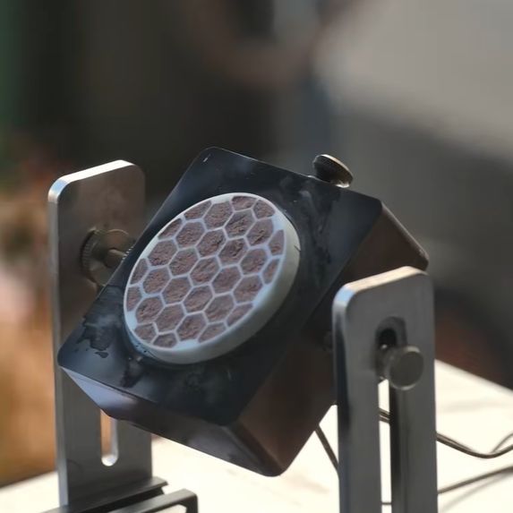

After the Orion capsule of the Artemis I lunar mission returned to Earth, it was found that massive chunks of its heatshield had been ripped off, posing a serious risk to any future missions. In a recent video in which [polymatt] takes a break from repairing old laptop shells and the like, he tries to recreate the Orion’s heatshield using a variety of methods and materials.
For this test a number of samples were created, each using the same kind of segmented structure as the larger Orion heatshield. The filler was created from the published materials for the heat shield by NASA, requiring just serious mixing.

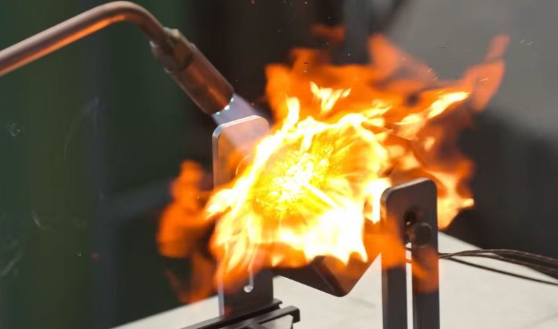

The resulting samples were then cured with thermocouples inserted, before they got blasted with the heat from a propane torch, trying to simulate the various re-entry patterns.

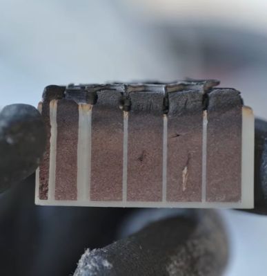

Perhaps unsurprisingly, the results matched the findings by NASA for why the Orion’s heat shield had failed, being the build-up of gases due to the sustained pyrolysis processes that eventually fractured the material. Despite some experimental flaws that injected residual heat from the copper structure, this still seems to be a pretty good setup to test ablative heat shields in DIY lab conditions.

    1. …Or some kind of strategic internal weak areas designed to break and shunt those gasses somewhere safe without compromising the critical outer layer

  2. Offgassing is definitely the #1 problem to solve. I worked on varying Avcoat’s long chain polymer crosslinking dynamics to create a more deliberate density gradient and to control heat flow. Basically a novel deposition technique to create offgas venting in the right places, to yield more stable pyrolization in the other right places. A bunch of regime changes happened right when I was submitting to NASA SBIR that caused their priorities to change toward non-ablative, reusable TPS, so I’ll bring it out of the lab when the mood changes again.
  3. Really appreciate the post and all the comments. This was a fun build. One slight correction is that the flame I used was oxyacetylene. Propane wouldn’t have gotten close to the temps.
