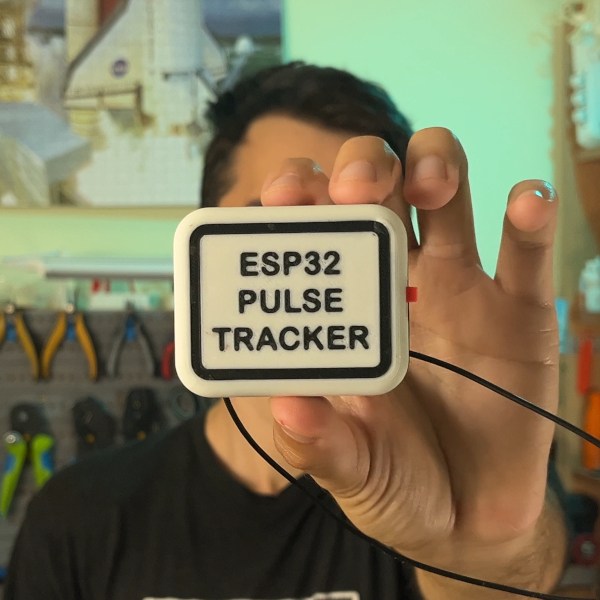

If you spend any time near a gym, you may be familiar with Bluetooth heart rate monitors — a small pack of electronics mounted on a strap round the chest which can relay heart rate data to an external logger or display. We’re pleased to see [Milos Rasic]’s project then, an open-source version of one of those monitors.
The heart rate capture is done by an AD8232, while the Bluetooth part is handled by a Seeed Studio XAIO ESP32 board. Power is provided by a single 3.7 V cell, with a boost converter to push that up to 5 V. The design omits a charge controller to keep things simple, so figuring out how to top off the cell is left as an exercise — no pun intended — for the user. Software is loaded through the Arduino IDE, which raises the possibility that other ESP32 CPUs could be supported with a bit of modification. All in all it’s a surprisingly simple project, and while the manufactured version is cheap enough it’s still very much worth having one that’s open source.

    1. I’m also surprised people choose ESP32 for battery powered projects.
      The nRF52 MCUs uses a lot less energy, has built in buck converter and they have an example of a simulated HRM in their SDK. There are plenty of modules to buy for them too. An nRF54L will draw even less, but I don’t remember if it can run directly from the battery.
      1. Indeed fascinating, to see the voltage being boosted from 3.7 -> 5 at an efficiency of about 90% (let’s be optimistic here). Then dropped down back to 3.3, causing another efficiency step of 66%, so the total efficiency going from 3.7 -> comes down to 60%.
        If the battery was to be connected directly to the 5V input (which should be ok as the board doesn’t need 5V) the efficiency would be 90%, the LDO on the ESP board wouldn’t have to work that hard, the battery would function longer, the system could be smaller/lighter/less complex.

        1. Buck is more efficiency than boost. As you say on a good day you might get 90% out of the boost side (3.7v –> 5v) while buck (5v –> 3.3v) can be as high as 95%.
          At best that might be only a ~15% loss, more likely over 30%.

  2. “The current plan for this project is to design a PCB around a new AFE IC”
    Use the AD8232, it’s well suited for your project, but since you are using a strap anyway, connect it in a two electrode config (that means, use the RLD pin of the chip to directly drive the inputs of the instrumentation amp via 10 MOhms, see AD8232 datasheet).
    And yes, use another controller which needs a lot less power. Reference – a Polar H10 can live from a new CR2032 coin cell for approximately 400 active hours ;)
    Nevertheless, nice proof of concept that you can design an HRM using available building blocks.
  3. fyi, pic12 is designed to run on an unconditioned battery supply, 2V to 5.5V, but the AD8232 only supports 2.0V to 3.5V. shrug
