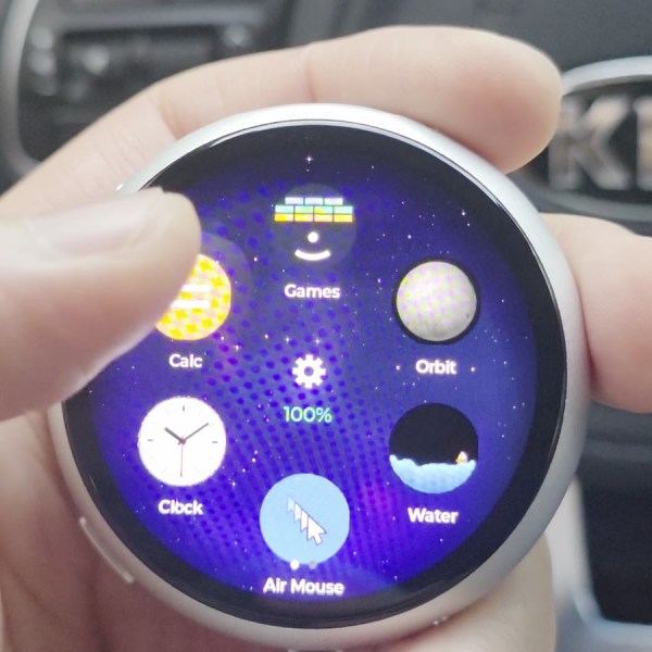

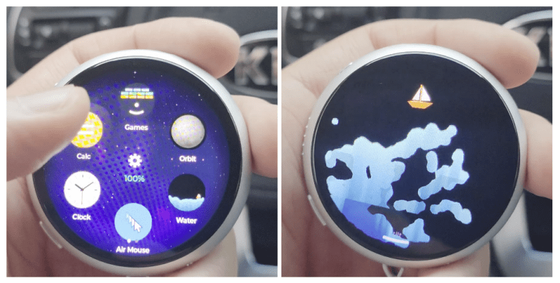

[curisama] has put together a project simply entitled The Badge. It’s simple enough, being a little round screen that you wear. Only, it does a wide variety of rather interesting things.
The build is based on the Waveshare ESP32-S3-Touch-AMOLED-1.75C. It’s not a very fun part number, but it describes a device which combines a 466×466 round display with a milled aluminium case and an ESP32-S3 to drive everything.
Neat, right?

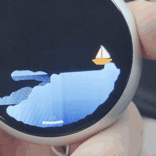

[curisama] started building a custom firmware for the device, intending to use it as an air mouse. Soon enough it had a touchpad, too, a bunch of extra keys, as well as a clock and some games. It was given the ability to record audio too, up to 52 minutes in WAV format. From there, it also gained a rather fetching liquid simulation, with water sloshing around the round display with a little boat riding around on it. This took some optimization, with [curisama] pushing the animation from 3 FPS all the way up to 18 fps, making it much more fluid and satisfying to watch. There were other optimizations too, with [curisama] figuring out how enabling the CONFIG_PM_ENABLE flag and some other tweaks could push standby battery life from 11.9 to 19.6 hours. Not a bad gain at all.

  2. The software work is nice! Those are some impressive performance improvements for a visual liquid simulation on something as small as an esp32 s3! The battery life is also impressive.
