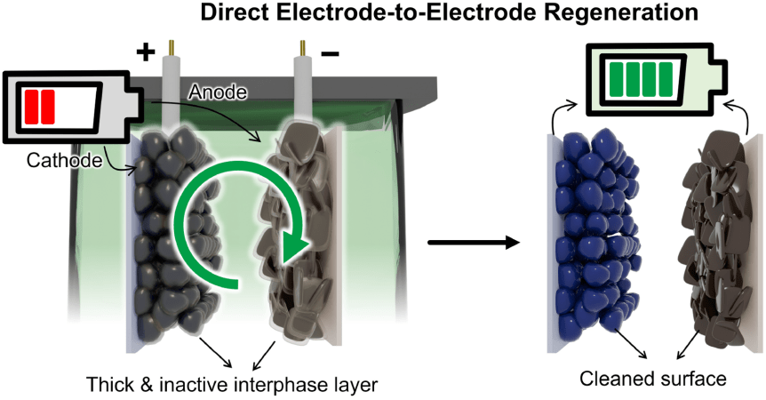

A drawing of a battery cell with gunk on the labeled anode and cathode called the "thick and inactive interphase layer." An icon of a dead battery with two red bars within a pictograph of a battery is superimposed. An arrow points to the right to a cleaner looking cell with a full battery icon with green bars inside showing the cell after regeneration.

The researchers found that by electrochemically dissolving the inactive electrode–electrolyte interphase layers that built up over time, they could rejuvenate the electrode without completely taking it apart. This direct electrode-to-electrode regeneration (DEER) uses 1,3-dimethyl-2-imidazolidinone (DMI) as a solvent for the process. Once reassembled, these regenerated cells have up to 95% of their original capacity while cutting the cost of recycling by over half.
