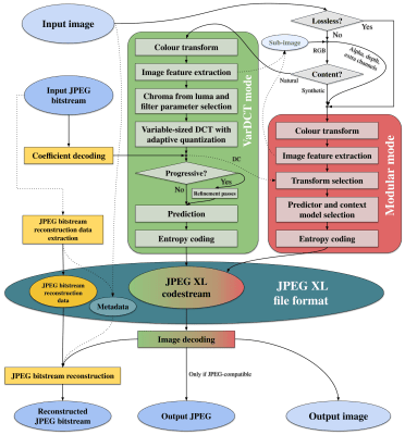

It was decided the resulting format would use the *.jxl file extension. The spec defined a format with a wide range of features well beyond what classic JPEG ever offered. It has lossless compression, including for the alpha channel, but also lossy compression available in different modes to suit both photographic and synthetic imagery.
It remains fast to decode—almost as fast as JPEG and much quicker than HEIC with x265. A key future proofing feature is that it can also handle 32-bit sample precision, and images with over a billion pixels per side—that’s a terapixel, if you’re playing along at home.

For context, vardct is jpeg-style compression (always lossy), and modular is png-like (typically lossless but can be lossy like with ‘lossy pngs’).
An implementor can choose wich behaviour is default or how its tweaked for their deployment.
