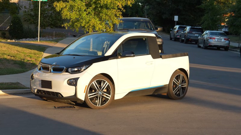

Trucks are handy, especially if you’ve got messy or dirty loads, but there aren’t a lot of options if you want a small electric pickup yet. [Michael Pick] decided to convert a BMW i3 into a utility vehicle.
After getting a new 12 V battery and cleaning the car up, [Pick] proceeded to disassemble the interior and remove the hatch from the car. Once he could look at the bones, he planned out the best places for the cut lines and removed the back half of the cabin.
The bed is built from plywood coated in penetrating epoxy and bedliner for weatherproofing, and special care was taken to seal the interface between the cabin and bed as the main electronics for the vehicle are housed in a compartment directly below. The taillight electronics were rehoused as the OEM lenses were too large to fit next to the tailgate opening.

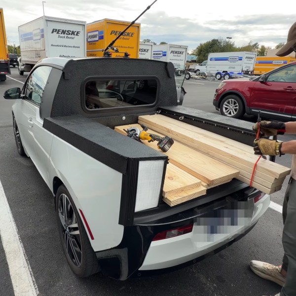

yeah the thing that’s a bummer about this is i don’t think it will be used as it was changed either. it’s just too small a bed to be very useful…very few scenarios where that bed will be more useful than putting your load directly on the factory rear seats. like, anything long will cause huge balance problems even if you can get it loaded somehow. anything heavy like bags of mulch or concrete readymix will simply not fit a very large number of them, and a small number would fit on the seats..
getting things into a rear seat of a two door car is much more difficult than simply placing them in a microtruck bed. This small bed is very useful, Its about the size bed you find in the MANY MANY kei trucks on the japanese market. This sort of microcamino conversion isnt anything new. Chevettes in the 80s and metros in the 90s were often customized similarly.
actually, actually, its not a two door car, its four door. these cars have the little hidden door that swing hinged out opposite to the main doors, so they are ACTUALLY quite easy to get stuff in and out of the back.
‘about the size’ doesn’t mean to me what i think it must mean to you?
most kei trucks have 6ft beds, which is barely long enough that you can set an 8ft piece of lumber in it and its center of mass is barely in front of the rear wheel. those “barely”s are everything: it is long enough. it is balanced.
this thing’s bed looks like it is 5ft long. it is not long enough for an 8ft piece to be balanced. If you put an 8ft piece in it, you’ll have to pile stuff on top of the front of it or you’ll lift the weight off the front wheels.
kei truck beds are as low as possible, which is key to their convenience in loading and unloading. this thing’s bed is almost a foot higher, both the bottom of it and the walls. that ‘convenience’ question is what would distinguish it from simply loading it through the hatchback.
kei truck beds are typically steel and you can confidently throw a heavy bag of material in them but if you habitually toss an 80lb bag of quikrete in there, you will soon hear the sound of debonding that wooden bed.
all the things that make a kei truck convenient aren’t actually present in this design, which is why i say, you’re better off loading it through the stock hatchback. it would be more convenient than the hatchback if it was, but it isn’t. the details all matter.
I don’t think its quite as bad as you paint it – yes its not the most useful small truck dimensions in the back, but it is still large enough to hold your potted trees, wardrobes etc etc that just won’t fit in a small vehicle at all otherwise.
If you are trying to compare it to a regular whitevan or larger pickup it doesn’t do well at all in volume transported. So if your needs are mostly transporting full/half sheets of ply or something again not that well suited. But compact car sized cheap to run and utilitarian enough transport vehicle it certainly could be, just down to what you actually need on the daily hauling stuff around.
Also bags of concrete/mulch/garden waste etc are far better kept outside of the passenger compartment – they tend to be rather messy and annoying to clean up afterwards.

As much as I hate to agree, I fail to see the point, the usability is reduced, the material choice is questionable (despite best efforts to protect against the environment). If the purpose was to have an electric vehicle to move cargo, then just take the back seats out, at least it would last.
That being said, The idea of keeping a vehicle like this running and the “Because why not” mentality is the point, and it deserves to be on here.
Wow, I wouldn’t have thought that was possible on a carbon fiber unibody.
it isn’t. that thing will snap like a twig on impact.
The front will fall off
I was cringing the whole time he was cutting on it. At least he was wearing a respirator?
I suspect it is heavily compromised now as the shell was designed as a whole piece, especially since he didn’t weld into the aluminum frame. If it’s only light loads, might be OK?
Technically it’s a carbon fiber body on an aluminum frame/sled – more tightly integrated than a normal body-on-frame, but still not really a unibody.
.. which is good, because if it wasn’t, he’d need to do major reinforcement of the back.
I’m still a little bit concerned about how much his crash safety is compromised, but heck, it’s still probably safer than any small truck from the 1990s or earlier…
Also, on the bright side, It looks like BMW designed the carbon fiber body in broadly the same way as they’d build it in steel, with thin panels spanning thicker beams and pillars in the usual places. So in a very broad sense the consequences of chopping it up should be similar. Since he’s cutting behind the B pillars, the cab stays mostly intact, and it should still retain a fair amount of rollover protection. Personally I’d feel a lot better with a roll bar or other cab reinforcement rather than just a plywood back, though.

i understand the impulse to fully weatherproof the bed, so that the underside of it can be treated like an interior space (because that’s what bmw engineered it as). and for all i know it’s possible these days to achieve that kind of seal with a coating on plywood. there are some great polymer coatings these days!
but
don’t build a plywood aquarium. if you are going to have a wooden deck, use slats like 1x4s or 2x6s or whatever. it’s like a deck. the goal is not to keep water from getting through the deck, but rather to let it drain to minimize ponding.
that’s my two cents on the least significant of this projects’ engineering mistakes :)
