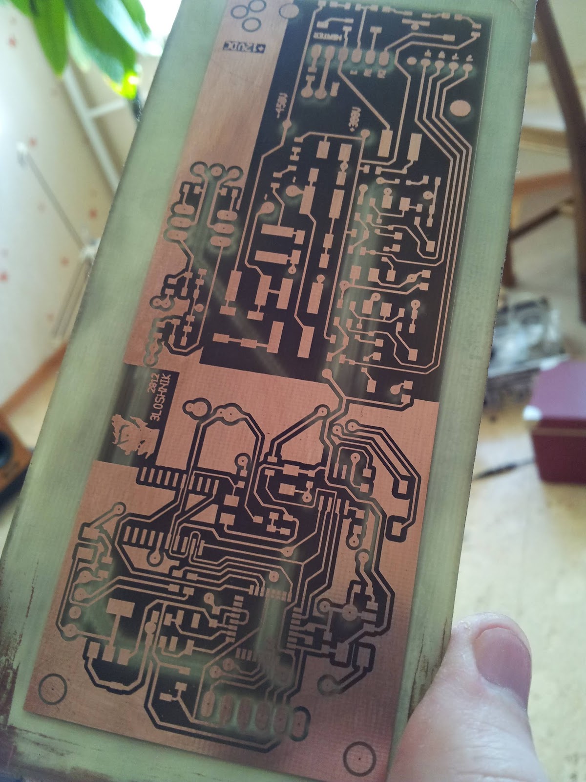

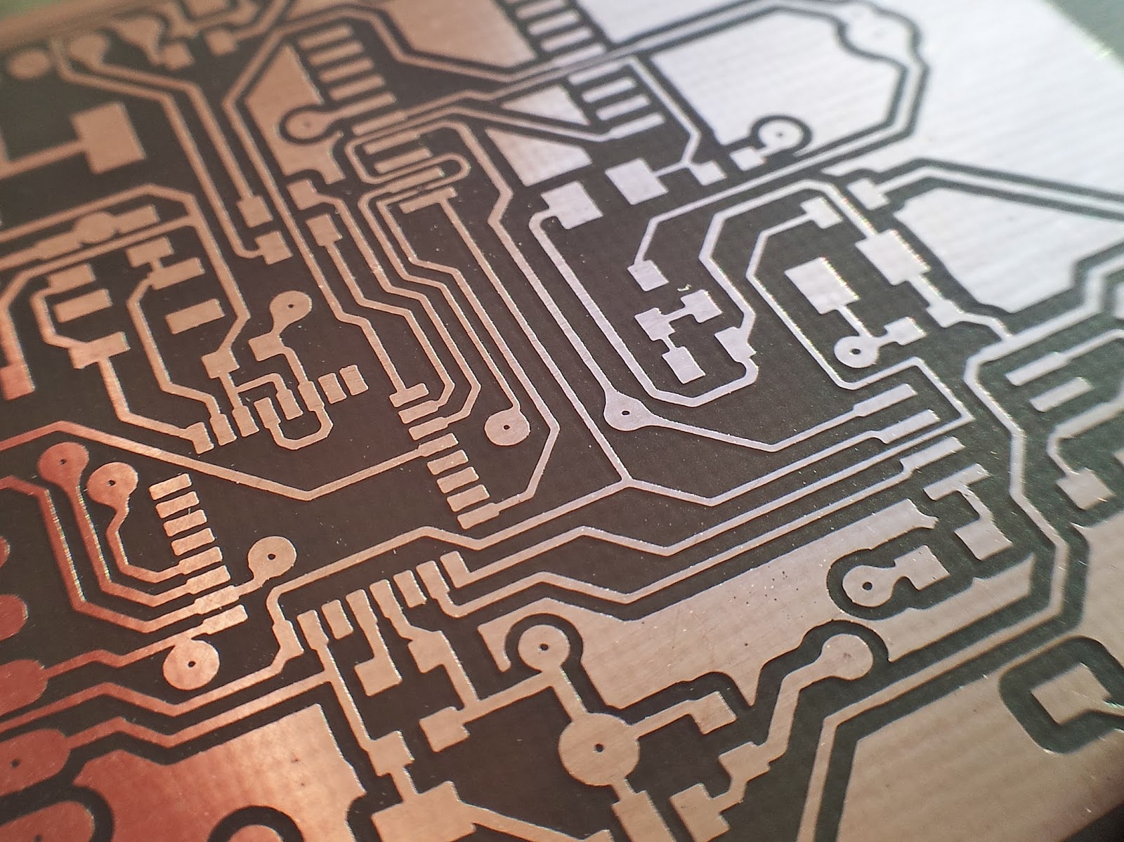

    1. Have you tried printing on thin glossy paper, prepping the boards with ammonium hydroxide and using a laminator? It’s really very easy and you can make perfect double sided boards with very detailed thin traces really really fast.
      This is from my latest project:
      http://goo.gl/LJymt
      Traces winding between SOIC pads are nothing to write home about. And it’s double sided.
      1. Nice work. I have been unable to get traces thin enough for soic without severe pitting. My process seems to differ from yours in that I use thick, glossy, photo paper, no ammonia prep, and an iron for transfer.
      2. It’s some random glossy coloured paper bought in a kids section of a local supermarket. It’s white on one side, coloured on another. Pretty thin, thinner than regular office paper, but not too thin so the printer handles it well. It has a Barbie picture on the package. Not sure if this description really helps :) I believe that the key ingredient is the laminator though, because it applies temperature and pressure evenly. Before getting one, I used to have pretty good results with photoresist/UV, but the effort for every board was huge compared to this method.
      3. That depends also of the laser printer used and its toner. A lot of laser printers just don’t cut it.
        Nice boards btw. Which printer did you use to make them?
      4. Canon LBP2900 or something like that. It was the cheapest on the shelf at the time. Really can’t recommend it because they explicitly remove it from their universal CAPT driver on Mac and you really have to spend some quality time with it before it can print for the first time. Shouldn’t be a problem on Windows though. With rare exceptions I only print boards so I’m running like 3rd year on the original refill.
