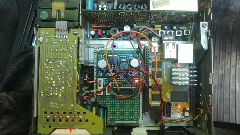

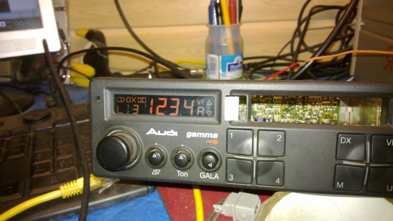

  8. Did something like this, but in more tricky way. I completely remove all parts for cassete deck, replace car stereo processor with my own module based on PIC18F2550 controlling FM/AM receiver, LCD and keyboard and exposing USB interface, and install Allwinner A10 board (Marsboard) with own power supply instead of cassete deck.
    http://www.stanson.ch/files/Audi/AudiGammaIII/processor1.jpg
    http://www.stanson.ch/files/Audi/AudiGammaIII/display1.jpg
    http://www.stanson.ch/files/Audi/AudiGammaIII/inside-marsboard.jpg
    In radio mode this works just like original radio, without any interaction with Marsboard. If you switch to Marsboard mode, keyboard become standard USB keyboard for Marsboard with additional interface for LCD. Marsboard runs Debian with mpd. mpd controlled via triggerhappy daemon listening for keyboard events. Also it has WiFi for music uploading, bluetooth for handsfree and A2DP stream receiving from phone, and SVOX pico TTS for voice messages about faults from car check system. Now I want to install cvoicecontrol for voice control, but it’s a bit tricky because it’s necessary to cancel music from microphone signal to make it working.
    Also, I readjust car radio AM band receiver to 27MHz CB band (some coil winding, caps matching and other ham magic with AM receiver part of car radio circuit), to listen truck drivers who use CB AM C15 european channel here.
