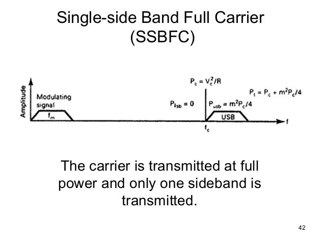

So, is this basically how those directional speakers that use ultrasound but you can hear normal range sound work?
Sort of… more like receiving a radio broadcast. A carrier signal is modulated with an audio signal. The result is the carrier with sum and difference frequencies that are well out of the audible range. As I understand it, this is normally done as a carrier and one sideband.
But when it hits a surface, the surface acts as a nonlinear device. This only works well when the sound pressure level is pretty high. Simplistically, the high pressure part of a sound wave has a pretty high limit, while the low pressure side can’t drop below a vacuum.
This causes the carrier to mix with the sidebands, causing sum and difference frequencies. The sum is even further out of the audible range, but the difference frequencies result in the original audio.
Works a bit like hanging up a wire and attaching a diode and earphones to it. The diode mixes the radio carrier with the sidebands, and the difference frequencies are the original audio.
For instance: 60kHz carrier, mix with a 2kHz tone. Result is a 60kHz carrier with a sideband at 62kHz. Feed this into directional ultrasonic speakers. This hits your head, mixes, and ignoring the sum frequencies, we get difference frequency of 2kHz.
As with a SSB AM radio transmission that does not suppress the carrier, the modulation should be at a max of 30% modulation to avoid distortion.
https://image.slidesharecdn.com/eeng3810chapter4-141012143102-conversion-gate02/95/eeng-3810-chapter-4-42-638.jpg
