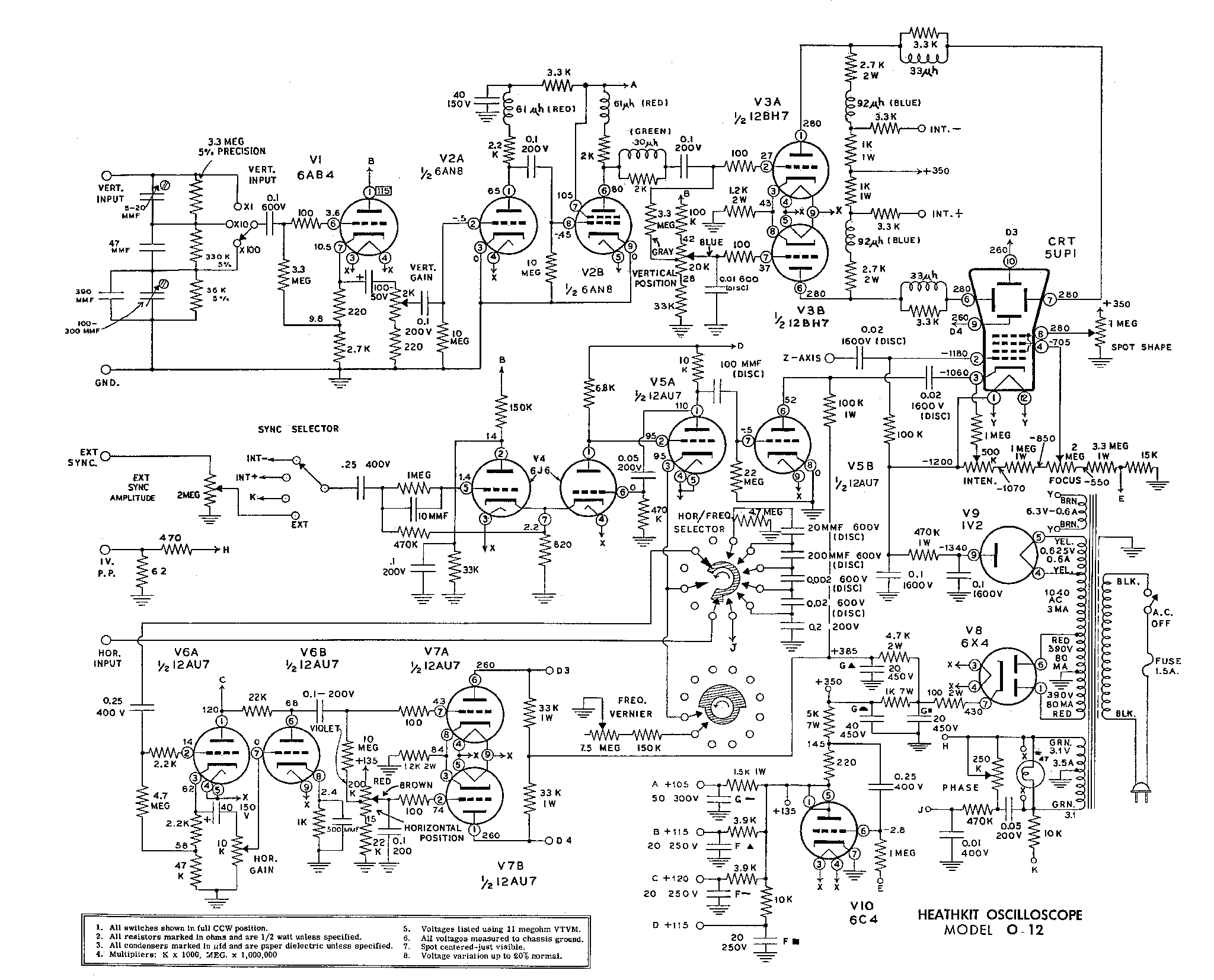

it drives me crazy, that he didnt fix the slewed x-axis
here is the schematic, please tell us how you would go about that
http://www.heathkit.nu/O-12_schematic_2048.png
Maybe the “horizontal position” potentiometer (down left) has something to do with the horizontal position.
The horizontal sweep would ideally be a perfect linear sawtooth, but that’s visibly not the case. I’m far from an expert at tube circuit topology, but V6 appears to be the sweep oscillator. I would check the capacitors in that section for degraded characteristics.
Anybody else?
yeah, that’s a super common problem on these older scopes. The timing caps for the sweep generator are probably actually in pretty good shape, given that they’re ceramic disc. Agree with Reboots about checking the caps around V6; they’re probably paper wax and both electrically and physically leaky. I’d also check all the power supply voltages, and start checking some of the higher value resistors which tend to drift high.
V7A and V7B form a totem pole output like half of a modern day “H” bridge. These two tubes have to be driven out of phase and the phase relationship is determined by how well the two 0.1uF 200V capacitors are matched. If they don’t match well the the “X” axis will be non-linear.
Anyway that would be the first thing I would check. In any case many of the liquid electrolyte capacitors are likely to be poor condition.
The second thing I would do is swap V7A and V7B to see if the non-linearity shifts to the other side of the screen. If it does shift them you have a worn out valve or one of more high resistance (fault) bias resistors.
The Designations D3 and D4 is the horizontal drive and you can see these designations on both the horizontal drive circuit and the tube itself.
swap V7A and V7BNot possible as it’s a dual valve.
One could swap with V5 or V6 (both 12AU7) and look for changes in the sweep. Thanks for the educational comment.

I have done computer simulations on this “valved” device. It is interesting to see how busy the capacitors really are. I can see why the old wax ones melt down. The vacuum tubes were simulated by resistors as they are not available on the simulation software. The tubes are simply current valving devices.
The problem with the X-axis is not apparent to me yet. I own the Heathkit O-11 and have modeled many of the circuits. Mine has the same issue with the “slewed” X-axis. My son is interested in the Z-axis of this scope as it may lend itself to full 3D capability.
Just think, 2 channel, full 3D capability. Would anyone ever find a use for it? LOL.
I have ordered a new cathode ray tube (CRT). So maybe that is why the trace is being compacted at the end of the sweep (slewed)?
Nope. Same exact slewed trace with a fresh 5UP1 (CRT). Next thing I would try is a fresh 12AU7 (horizontal sweep tube), however mine looks to have a pretty fresh getter. So, that may come later.
The O-11 manual does mention focus issues at the right side of the CRT, which is perfectly normal for this unit. The manual says it is due to amplifier design and compromise between sensitivity and bandwidth; whatever that means.
