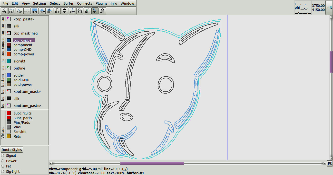

For those using the FOSS PCB layout software PCB-RND, we’ve got it covered….
https://4.bp.blogspot.com/-6Ffi9OGGFnY/WbJunPBDd7I/AAAAAAAABB0/sK8MtByUrnAqtojNRPzul4ntYdyfuua2gCLcBGAs/s1600/multiple-layer-hpgl-artwork-imported-into-various-pcb-rnd-layers.png
