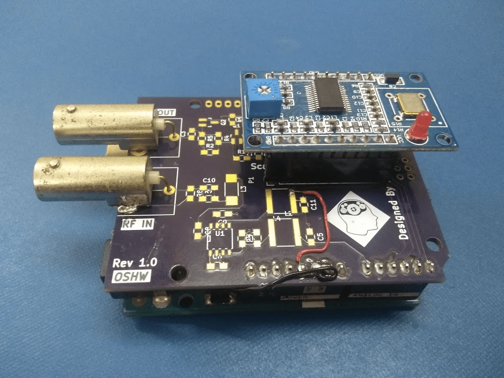

Let’s simplify things a bit. Say I have a simple filter I want to characterize in which case phase may not be necessary for my particular applications. I would just like to obtain the frequency-attenuation plot for the circuit so that I can use it correctly. In such cases, the DIY approach is the best and I would like to highlight a project on Hackaday.io for beginners. The idea is simple and involves using the Analog devices AD9851 to generate the desired signals.
The received signal power levels are converted into a voltage using the AD8307 logarithmic amplifier (datasheet, PDF). This voltage is read by a microcontroller and the results, in this case, are plotted using a Python script. Another restriction to this design is the 70 MHz upper limit though it may work for a lot of people getting started with such projects.
In my quest for a simple experiment, I purchased some AD9850 modules, op-amps, and other tidbits from eBay and made a PCB in KiCAD. I built the project in the Arduino UNO shield layout because my intention was to test it on an Arduino and then move up to an STM32 Nucleo which was also bought on the cheap. My revision 1.0 had some basic bugs so it is still a work in progress but I am sure it will work the same as the above project. Feel free to explore it and make one for yourself. Mine is shown below in OshPark Purple.

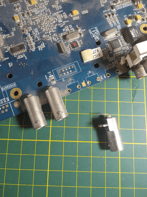

I did salvage the connectors from an old DVR board I had lying around so I suggest you replace that footprint with whatever you intend to use in your build.

A quick note re: your salvaged BNC connectors. If they are from a DVR they are likely the ‘video’ type which is a 75 ohm connector, rather than the usual RF impedance of 50 ohms. They are sort of mechanically compatible but probably not what you want to use! See http://www.wecusurveillance.com/files/891125/uploaded/507hohm.jpg for a quick ‘spotters guide’.
They will be completely mechanically compatible by design, but you are correct, they will present an impedance mismatch.
The center pin is different sizes, so if you mix 50 and 75 ohm connectors you will either have a loose connection or ream out the fingers.
I have 75 ohms cables with dielectric BNCs.
