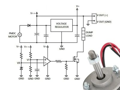

Suggested voltage regulator for pedal-powered generator. (Credit: T. K. Hareendran, EDN)

    1. It’s used to dump extra power to a dummy load (large resistor) so it doesn’t exceed the input maximums of the voltage regulator.
      I didn’t RTFA but that’s my read on the schematic
    2. guess you didn’t RTFA either lol:
      “The core principle is straightforward: the raw input voltage (VT) is continuously monitored and compared against a stable reference voltage (VR). When VT exceeds VR, a power MOSFET activates the dump load, which must be capable of safely dissipating the excess energy.
      Conversely, when VT falls below the reference, the dump load is deactivated. To prevent rapid switching near the threshold, it’s advisable to incorporate a small amount of hysteresis into the comparator circuit.”
      It’s a really, really crap circuit tbh. I’m not even remotely surprised the dude proposing this in 2025 is “self taught”. In 2025 you should be using a modern brushless motor and some switch mode power staging…. I guess I’m a curmudgeon.

          A much, much better solution to “excess voltage” would be to store up that excess in a super-capacitor. If the One Who Pedals finds out that some of that effort is just being dumped as heat just to keep the load happy, you’re going to have to encourage them a lot more to keep at it. Whereas if every now and again that extra effort is saved and put to work a bit later, that’s far more agreeable. You could even arrange some feedback to your Prime Mover so that they know when they’re over doing it, and help them try to keep an even output.
