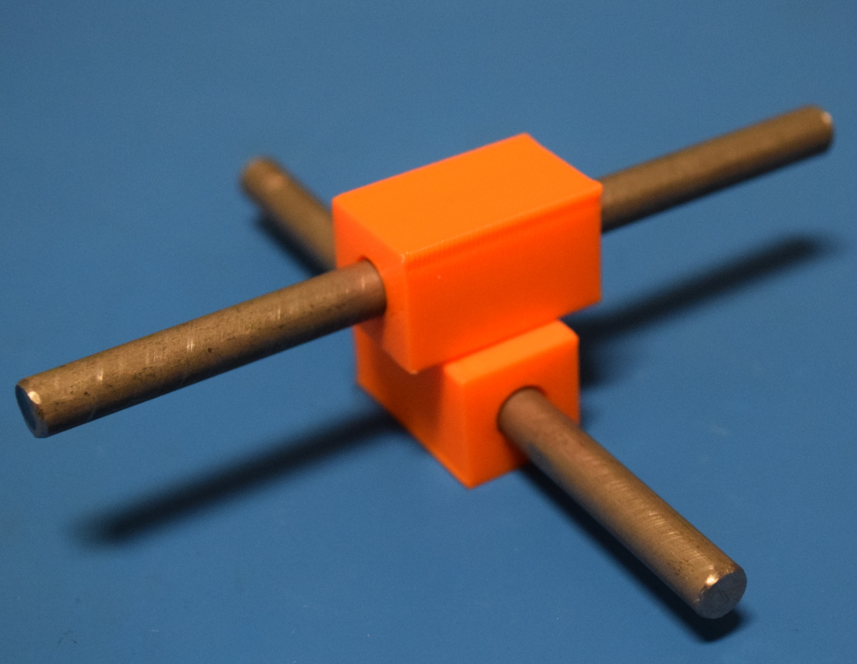

Testing Procedure
To test the different glues, I came up with a simple testing procedure. It’s perhaps not the most scientific of setups, but I think gives me enough information given the relatively stress-free life a 3D printed part lives.
The test setup consists of two rectangles, printed at fairly typical settings (0.2 mm layers, 30% infill), which are glued together at 90 degrees of each other. Through each rectangle is run a metal rod: one of the rods is inserted into two eye hooks installed in an overhead beam, and the other rod is attached to a luggage scale with a short length of chain.
Pulling down on the luggage scale allows me to put tensional force on the two glued pieces, with two possible outcomes: either the printed piece breaks, or the glue releases. For my purposes, I will consider the printed part breaking before the glue releases to be an automatic “win”. Remember, my goal here is only to find if the glue is strong enough to be used for typical 3D printing applications; not an attempt to find the ultimate strength of the bond.

For each glue, a pair of rectangles was printed and sanded on the mating surfaces with an 80 grit sanding block. The pieces were then glued as per the instructions, and held together with clamps for the recommended cure time.

As expected, this glue preformed very well. The luggage scale maxed out (100 lb), and shortly after that one of the rectangles broke.

When tested under load, the Loctite Super Glue Gel survived past the breaking point of my test pieces just like Weld-On #16. I’ll admit I was very surprised by this, as I had assumed none of the glues would have been as strong as the solvent welded pieces.

In the load test, Gorilla Super Glue did quite well, breaking at 87 lb. Even though this glue didn’t end up being the strongest of those tested, the long work time is extremely handy and makes it stand out from the others.

Performance in the load test was the poorest out of all the glues, the bond broke at only 50 lb. To be fair there might be other types of plastic that this product works well on, but PLA is certainly not one of them.

Unfortunately, DAP Rapid Fuse didn’t do well on the load test. It broke at only 57 lb, the second lowest result. I was particularly disappointed with this one, as I’ve seen this glue specifically mentioned online as being a good choice for PLA parts.

In what was probably the biggest surprise of this test however, the basic HDX Super Glue did not fail under the load test. The printed test pieces broke before the bond released, making this an automatic “win”. Working with it is kind of terrible, but credit due on the strength of the bond.
