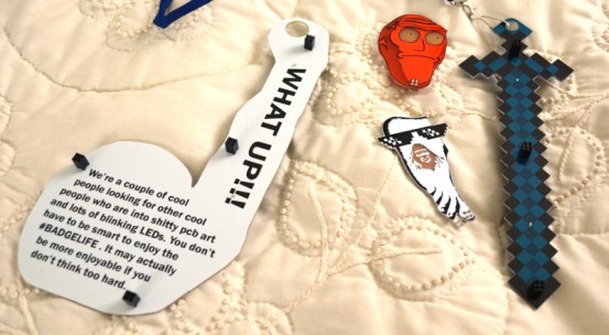

Before the Shitty Add-On standard, there were several independent conference badges with their own hats and add-ons. The 2016 Queercon badge came with hats, powered by two small expansion ports on the top of this cuttlefish badge. The expansion ports provided power, ground, and an I2C bus on a 1×4 connector, giving these cuttlebadges unicorn horns, an emo haircut, or a top hat studded with LEDs.
In 2017, there was an obvious need for a standard for badge-addons, with even more standards created. Luke Jenkins published the MiniBadge standard for SaintCon, an impressive standard that implemented 5V, 3V3, I2C and SPI in less than a square inch. The results were impressive, with more than a dozen minibadges being built for the main SaintCon badge.
Finally, we come to the 2017 / DEF CON 25 AND!XOR badge which featured Hunter S. Rodriguez and a Futurama Brain Slug.The schematic for this Brain Slug is very simple, just an ATtiny85 microcontroller and a handful of WS2812b LEDs. It’s blinky, it’s bling, and since every board house can do green solder mask, you can make a Brain Slug PCB pretty easily. Only about ten or so of these Brain Slugs were ever made (although the Gerbers are right here so knock yourself out), but it was a precedent for add-on bling.
DEF CON 25 came and went, and a few lucky people walked away with Brain Slugs. Some time around February, 2018 — the time of Chinese New Year, because that’s obviously the best time to start any sort of electronic project — a few members of the Badgelife collective started asking a few questions. The previous two years of badgemaking showed everyone add-on badges were a thing. The future would have minibadges, or other weird PCBs hanging off the big badges. What if there were a standard for Badgelife add-ons? What if these pieces of indie electronic art could host Brain Slug-like add-ons from multiple creators? The AND!XOR badge really only supplied power to the Brain Slug, but adding holes for pin headers on a badge is effectively free. The only thing you need for this is for the entire group to come to an agreement on a standard pin out.

By all accounts, the Shitty Add-On standard is a success, but it was not perfect. Mechanically, standard 2×2 headers aren’t very strong, and that goes doubly so if you’re using SMD male headers on the add-on. Not many people used the I2C bus, but there were a lot of people that wanted to extend their WS2812 or APA101 RGB LED strings.
A standard isn’t a standard unless there’s a better one, so now the community of badge makers has settled on a newer, betterer standard for Shitty Add-Ons. It’s Shitty Add-On V.1.69bis (SAO.69), and it vastly increases the capability of the Shitty Add-On standard while retaining backwards compatibility.
  • A New Connector!
Because of the need for a low-cost connector, and the need to retain backwards compatibility, SAO.69 will use a standard 0.1″ 2×3 connector.
Badges use 2×3 female (non pinned) headers, 0.1” pitch. Similar to last year, but 6 pins. It is highly suggested that badges use through-hole connectors, lest SAOs rip off your pads. These may be keyed, but through-hole 2×3 keyed connectors are either impossible to find or absurdly expensive. The thing to search for to find a keyed badge connector is, ‘2×3 Pin 6 Pin With Polarizing Key’. eBay will turn up results for that, but you can only buy 100 at a time. AliExpress reportedly has them, but they’re $0.40 USD / piece.
The best connector. It’s unobtainable. I own 75% of the world’s supply.
Needless to say, the keyed badge connector is rare, expensive, and difficult to find. However, it perfectly solves the problem of Add-Ons coming loose. These connectors have been verified as fitting a standard IDC shrouded header. Use the best badge connector at your own risk.
Add-ons use a 2×3 male, pinned, shrouded connectors. These are actually some of the cheapest and most ubiquitous connectors available, and if you have a device that has an AVR ISP header, this is the same connector. As with the badges, it is highly suggested you use a through-hole header for mechanical strength.
