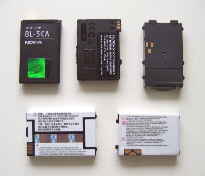

A series of replaceable smartphone batteries from the GSM era. Few of us needed to swap them out regularly, but it could save you some trouble if you got caught short of charge in a bad spot and a friend had some juice left in a similar phone. Credit: Phrontis, CC-BY-SA-3.0

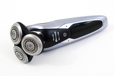

Many devices, like this Philips Norelco 9700 shaver, feature in-built batteries. The company specifically advisers customers not to attempt “to open the product to
remove or replace the built-in rechargeable
battery.” Credit: moo.review, CC-BY-2.0

  16. My girlfriends vibrator failed because the rechargeable battery died. I tried to open it but they used some kind of security screws. If it had used an 18650 it could still be in service. She had to buy a new one.
    This is also why I have always bought a corded electric shaver. Once the battery dies it end up in the trash.
    1. Hah. My shaver is years old and runs on steroids!
      Originally had one internal 1,2v NiCd which of course died. but instead of replacing the battery I removed it and replaced the mains socket with a low voltage DC barrel connector.
      -> The motor now screams away with and external 3,3V SMPS. :-)
      1. My Philips shaver had NiMH batteries, but the controller in the device bricked itself when the cells ran completely empty. The charger part of the shaver still works, it just won’t run. I can poke voltage into the gate of the main output transistor and latch it on, so there’s nothing technically wrong with the circuit.
        I replaced the battery cell and installed a simple switch to bypass the CPU.
