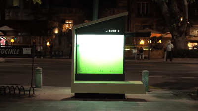

The layout of the Liquid3 bioreactor. Credit: Liquid3
In reality, though, the devices serve a real and positive purpose. The photo-bioreactors, as they are technically known, are air quality control devices built specifically to suit the urban environment. Inside the tank, microalgae is grown in 600 liters of water, using CO2 from the atmosphere combined with photosynthesis to produce oxygen and biomass. One LIQUID3 bioreactor is capable of replacing one 10-year-old adult tree, or a full 200 m2 of lawn. This is of huge benefit, as the bioreactors can be built and installed far more quickly, and start processing polluted air immediately.
Like trees, the devices are solar-powered, with panels on top to capture light and turn it into electricity. Built-in lighting allows the microalgae to photosynthesize year round, even in the dimmer winter months. There’s also a pump which captures polluted air and bubbles it up through the water to feed the algae. The LIQUID3 bioreactors are built with an eye to civic duty, as well. They’re constructed to also serve as city benches, while also providing a power outlet for charging mobile phones.
There’s a pleasing glow to the bioreactor when powered up at night. Credit: YouTube/UNDPSerbia
The bioreactors are well-suited to the built environment of Belgrade, Serbia. The city is subject to significant air quality issues, with high PM2.5 counts by virtue of two neighbouring coal power stations. Serbia as a whole records 175 pollution related deaths per 100,000 people, making it Europe’s worst performer by this metric. It’s also 33rd in the world for having the worst air quality.  Anecdotally, activists complain of pollution so bad that it can be readily detected by sight, smell, or taste during the worst periods. If you were in Beijing in the winter of 2015/2016, you’d be familiar with the flavor.
Much of the uproar towards the devices is misguided. The bioreactors aren’t intended to replace urban trees with scary-looking machines. Instead, they’re designed to slot into spaces where growing a tree is impractical. Plus, the microalgae bioreactors offer efficiencies that trees and grasses simply can’t match. Microalgae can be capable of removing CO2 at a rate 10 to 50 times faster than even mature trees, to boot. Once grown, the microalgae can be harvested and used as a potent fertilizer, as well.
As valuable as efforts like the Trillion Trees project may be, there’s something to be said for the sheer practicality of building compact bioreactors. The fact that they start capturing useful amounts of carbon dioxide from day one is just a further mark in their favour. As the world struggles against rising carbon levels in the atmosphere, expect to see bioreactors like these proliferate in cities around the world. They may just be a key weapon in the fight against climate change, while also transforming our urban spaces into the futuristic cityscapes science-fiction had promised us.

    “One LIQUID3 bioreactor is capable of replacing one 10-year-old adult tree, or a full 200 m2 of lawn”
    Anyone have the numbers on this claim?
    “one 10-year-old adult tree”
    I thought it was young, growing trees that take in the most carbon?
    Then again, is 10 y/o “adult” for most tree species?
    1. Define “adult” in trees – if it is when they are first able to reproduce in many trees you need to add a few more decades, if it is using a human lifespan ratio quite possible need to add a century before it is “adult”, if however you just mean it looks like a tree not a stick with a few leaves 10 years might well be enough. There are also of course wild variations between tree species.

  12. there is no way in hell that this thing works. having worked myself with micro-algae during my bachelor thesis i can tell you that besides the obvious stupidity of the co2 and air cleaning facts those things are almost impossible to keep “clean” meaning they are very prone to bacterial infection. also micro algae unlike plants and bacteria are almost impossible to genetically engineer. and lastly they usually tend grow extremely slowly or even to starve to death and get yellow to brown if you don’t give them a nice and juicy buffered growth medium full of nitrogen protein and sugar. so yeah you can use them as fertilizer later on but all the nitrogen you get is the nitrogen you put in to grow them in the first place they don’t fix nitrogen from the air.
    1. No personal experience but I know of many studies that have really been praising how hard it is to go wrong growing some specific algaes – maybe the ones you were worked with are really really tricky, but it seems that is not universal. Requiring the right growing medium wouldn’t be anything new, so there you could be entirely correct. Though I’d not be so certain there is no nitrogen capture going on – lots of polluted air bubbling through a wet chemical soup, almost certainly going to be some interactions going on that could end up as a capture.
      Also for this use case do you care if it gets infected by something else anyway? The primary point seems to be cleaning the air which just bubbling the air through water would do at least to some extent. And you have to go around cleaning and harvesting it too.
      1. arguably you are right some species may be more adapted and resilient that the strain we used back in the day but usually those are the one growing in brine where they can out compete almost all other microorganisms. however working with brine poses some challenge on its own. as far as i know micro algae don’t fix nitrogen and the tiny amount of dissolved nitrogen in the solution is not biologically available to them. or you mean some sort of interaction with the growing medium itself? without knowing the details of what they are using i cant really comment on that but seems unlikely.
        from an “air cleaning” perspective no i don’t care whats growing in there might as well be plain water and green dye for aesthetics reason for all i care but if you start to talk about carbon capture heck yeah you should care …. no algae no photosysnthesis => no photosysnthesis no co2 capture. as simple as that
        1. >no photosysnthesis no co2 capture
          Agreed, mostly anyway – some might well get dissolved and react with other crap in the algae tank’s water so it sticks around. But as you have to go round cleaning them and harvesting them all the time a little period when the algae is not very healthy or dead inbetween doesn’t change much – just means the system is operating at lower efficiency than it could, but it is still capturing just fine for much of the time.
          Yeah I don’t know about a fixing nitrogen species (wouldn’t surprise me though), but with the amount of stuff in a cities air I would expect it is filtering out ammonia and nitros oxides that will then react at times with something else in the wild mix of stuff there to stay stuck in the algae tank and may well become bio available to the algae. There is just too much stuff particulate and gaseous in a cities air to really even make good guesses as to all the chemistry that will be going on.

  15. These tanks won’t last 2 weeks in major US cities. Within days, there will be scratched all over. Eventually broken into pieces by maniacs using whatever they have on hand. The mess will also make the bench unusable.
    1. I actually seen one of those first hand. still there after almost a year. sort of clean, no vandalism on it. Though in summer it was overgrown to the point of being no longer transparent.
      On another hand – Belgrade has surprising amount of trees in many areas. and without them – summer would not be tolerable here.
      As for vandalism – do not see it as big problem here. Grafiti – yes, but serious vandalism – no.
  16. Wait… An included electric light is the source of photosynthesis… Do you mean the energy source for the CO2 capture comes from CO2 emitting sources? When the capture mecanism is freaking photosynthesis? And it’s not an april’s fool, really ? Shame on you hackaday for this arty greenwashing BS. What kind of second Law breaking rubish is that…
    1. I know ithas a dedicated Solar panel. That’s irrelevant: electricity production is still massively CO2 emitting overall. The Solar panel could be (and should be) used to power something else.
