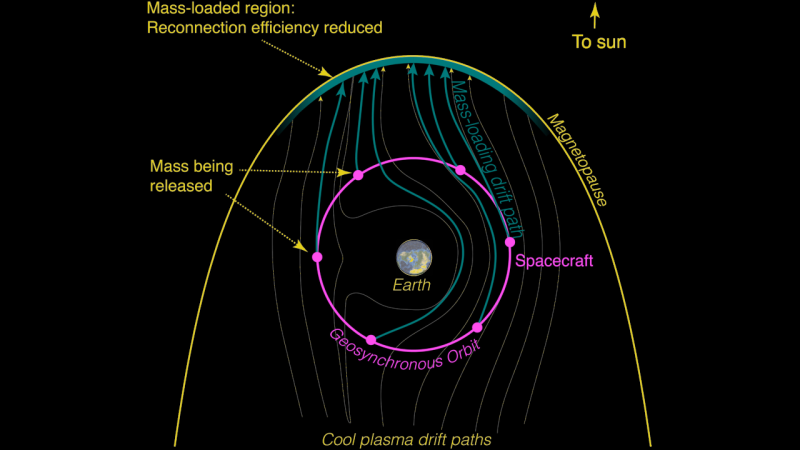

While the authors of the paper refer to this concept by the compelling name StormWall, it’s not a physical wall. It’s actually just gas, likely of alkali metal atoms, to be deployed by solar-powered satellites.
To oversimplify, the proposal is to release lots and lots of neutral gas in Geosynchronous Earth Orbit (GEO), in what the researchers call “artificial mass loading” — the neutral gas would of course be ionized by the storm, but in so doing could absorb up to 50% of the incoming energy of the geomagnetic storm, frustrating its coupling to Earth’s magnetosphere. As a bonus, it would protect not just terrestrial assets like the power grid, but everything in a lower orbit than the mass load: everything from communication satellites in GEO to the International Space Station. Assuming its hasn’t been reduced to debris laying at the bottom of Point Nemo by then, anyway.

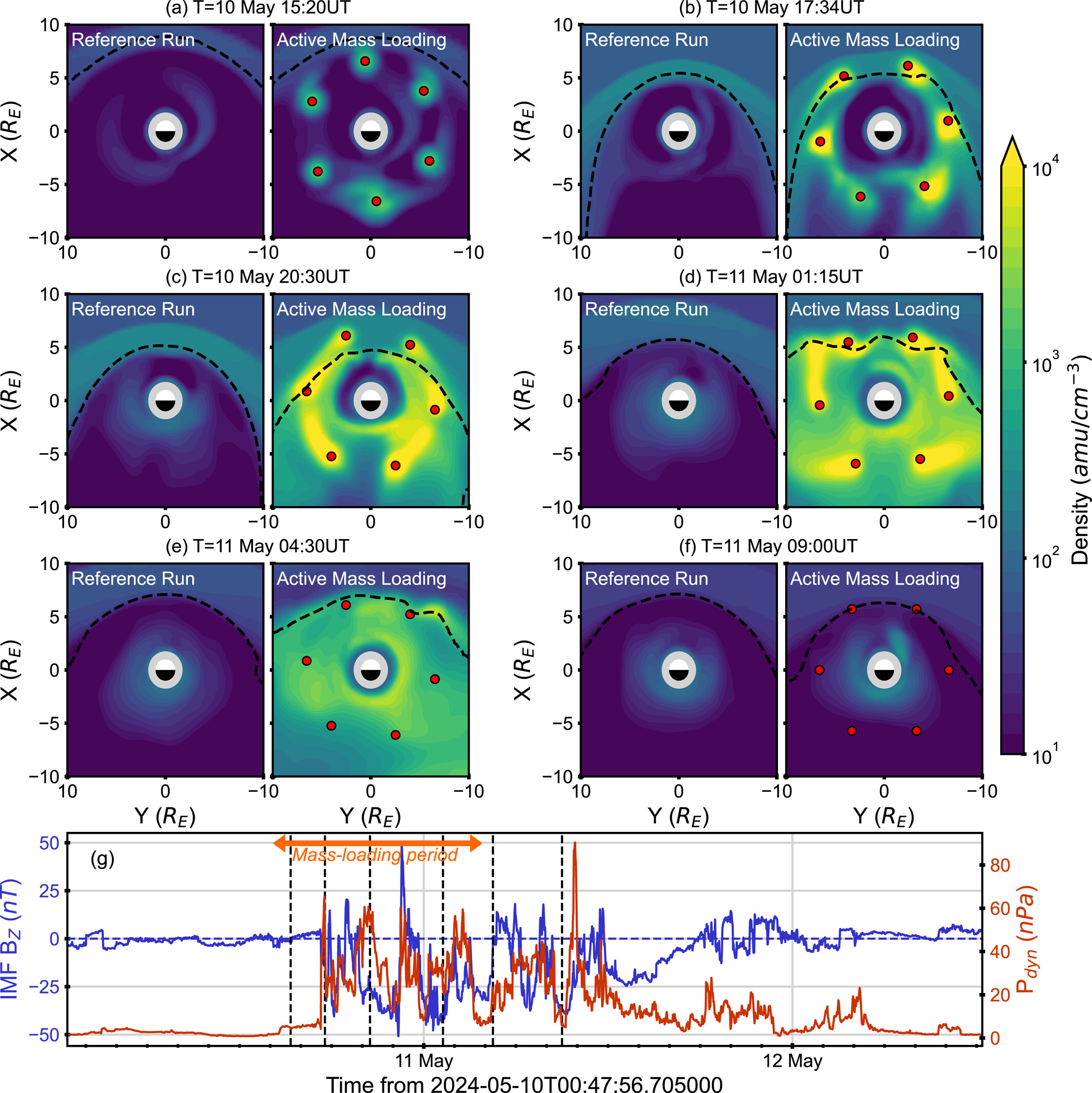

In simulations, the StormWall required 384,048 kg of gas, which is not exactly trivial. But even accounting for tanking, the researchers estimate that would only take about six launches of SpaceX’s Starship. Though that does assume its GEO capabilities end up being roughly equivalent to the massive vehicle’s projected 100-tons-to-Mars payload capacity.

Uh…. the solar storms observed at Earth are the CME arriving. That’s literally what they’re simulating. The Carrington event was a CME so energetic it took less than a day to arrive.
The reason the geomagnetic field is so affected is because it’s being heavily loaded with charged particles, causing the magnetic field to reconnect all over the place. Loading it with neutral particles suppresses that.

You’re not keeping it in place. It’s a one time shield. You release it, it gets ionized rapidly, and temporarily creates a heavier plasma (it’s a barium gas) on the Earth-side of the magnetosheath and prevents effective magnetic reconnection.
It’s not hard theory, it’s just the practicality of a few hundred metric tons of barium gas in orbit.

So I read the paper and the work that it’s based on (Wescott et al 1994.) This idea is just a scaled up version of a satellite called CRRES that was already proven to work. It’s basically a big canister of boron/titanium thermite powder with barium metal mixed in. Stormwall would be several hundred tons of the stuff spread across however many satellites. You would launch them into geostationary orbit and they would just stand on alert indefinitely. When a CME event is detected, the thermite gets ignited and the mixture heats in each sat until burst disks fail and the molten goop vaporizes out into space.
