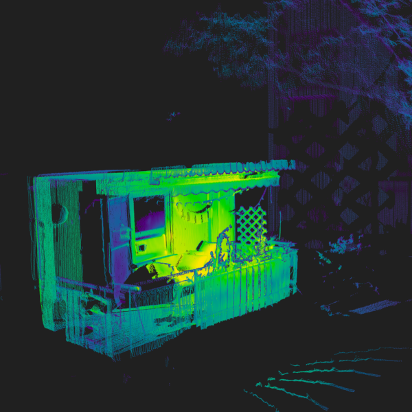

Although there are plenty of methods for effectively imaging a 3D space, LIDAR is widely regarded as one of the most effective methods. These systems use a rapid succession of laser pulses over a wide area to create an accurate 3D map. Early LIDAR systems were cumbersome and expensive but as the march of time continues on, these systems have become much more accessible to the average person. So much so that you can quickly attach one to a Raspberry Pi and perform LiDAR imaging for a very reasonable cost.
This software suite is a custom serial driver and scanning system for the Raspberry Pi, designed to work with LDRobot LIDAR modules like the LD06, LD19, and STL27L. Although still in active development, it offers an impressive set of features: real-time 2D visualizations, vertex color extraction, generation of 360-degree panoramic maps using fisheye camera images, and export capabilities for integration with other tools. The hardware setup includes a stepper motor for quick full-area scanning, and power options that include either a USB battery bank or a pair of 18650 lithium cells—making the system portable and self-contained during scans.
LIDAR systems are quickly becoming a dominant player for anything needing to map out or navigate a complex 3D space, from self-driving cars to small Arduino-powered robots. The capabilities a system like this brings are substantial for a reasonable cost, and we expect to see more LiDAR modules in other hardware as the technology matures further.

  2. Does anyone know how the lidar point cloud gets converted to color? I see there is a camera and fisheye lens, but then what?
    1. The lidar is mounted near the camera, so for each point it uses the color of the pixel which was in the same direction.
      1. not really. the mechanical 2D lidar shots a circle orthogonal to the camera direction, but instead the fisheye photos are stitched into a 360×180° spherical map from 4-8 angles, each with ±2 HDR bracketing using Hugin.
        the point cloud is assembled from the laser planes (0.16° steps around the vertical axis) using the absolute stepper angle and calibrated the offset translation and rotation between lidar and rotational axis. the lens’ focal center sits exactly over the rotation, so there is no offset in the photos (otherwise you couldn’t really stitch them together but had to rely on a far more complex process).
        Each point in the 3D point cloud can be interpreted as a 3D vector from zero, where it’s latitude and longitude component can be directly used to sample the pixel color in the pherical panorama, because conveniently, it uses the same axes ;)
        I described it a bit more in detail here:
        https://www.reddit.com/r/LiDAR/s/Fbz9ukEJ63
        because I’m actually the author 😄
