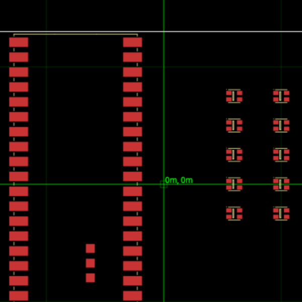

The example project imports a Pico microcontroller and some smart LEDs. They do appear graphically, but you don’t have to deal with them graphically. You write “code” to manage the connections. For example:
<trace from={".LED1 .GND"} to="net.GND" />
If that looks like HTML to you, you aren’t wrong. Once you have the schematic, you can do the same kind of thing to lay out the PCB using footprints. If you want to play with the actual design, you can load it in your browser and make changes. You’ll note that at the top right, there are buttons that let you view the schematic, the board, a 3D render of the board, a BOM, an assembly drawing, and several other types of output.
