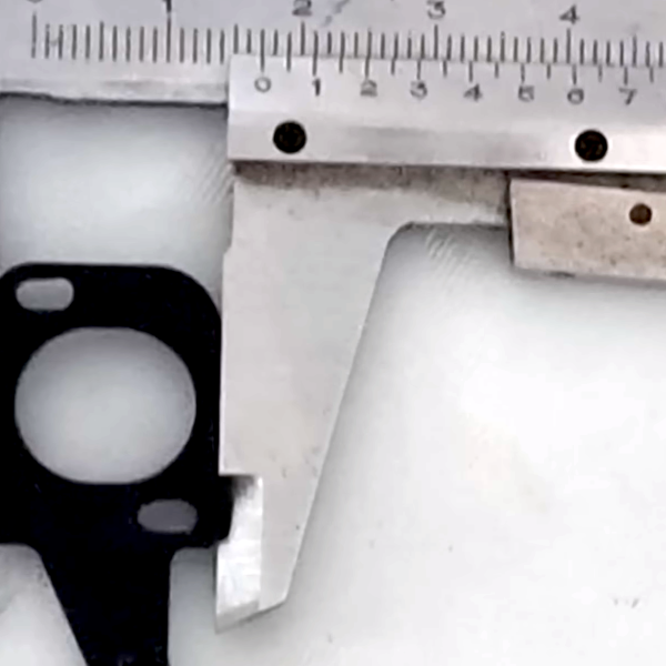

We’ve certainly seen people take a photo of a part, bring it into CAD, and then scale it until some dimension on the screen is the same as a known dimension of the part. We like what [Scale Addition] shows in the video below. In addition to a picture of the part, he also takes a picture of a vernier caliper gripping the part. Now your scale is built into the picture, and you can edit out the caliper later.
He uses SketchUp, but this would work on any software that can import an image. Given the image with the correct scale, it is usually trivial to sketch over the image or even use an automatic tracing function. You still need some measurements, of course. The part in question has a vertical portion that doesn’t show up in a flat photograph. We’ve had good luck using a flatbed scanner before, and there’s no reason you couldn’t scan a part with a caliper for scale.
This is one case where a digital caliper probably isn’t as handy as an old-school one. But it would be possible to do the same trick with any measurement device. You could even take your picture on a grid of known dimensions. This would also allow you to check that the distances at the top and bottom are the same as the distances on the right and left.

    1. I often just put a ruler beside it and try and make sure the camera is as parallel to the surface as possible and as far away as reasonable, that way the X and Y dimensions are as close as possible and you only need one axis for scale.
      1. Why don’t we have caliber paper? A series of known points with a QR code and an app that turns it into a scaled drawing.
    2. A round coin is an excellent scale indicator. I’ve used one (Australian 20c coin) many times when photographing WWII military vehicles I intend to produce a scale model of, or markings on these vehicles I want to produce a decal of.
      Being round, a construction line can be drawn across the coin’s diameter in the photo that is always parallel to the focal plane of the camera, which is needed when scaling panels that are not perfectly perpendicular to the camera.
      1. While you can always find a parallel line to the camera’s focal plane from a round object, I doubt you can actually find it with any accuracy in practice.
        The coin will be stretched and squished by the lens distortion and the perspective error, so you kinda have to guess what diameter line actually lines up with the image plane. You can measure the coin crosswise to find out how much the photograph is distorted somewhere close to the coin, but that doesn’t apply to all parts of the image.

    This trick with the calipers applies to photographs where the focal distance is unknown. But, if you set up your camera at a known distance and zoom it all the way in, you can pretty much make the same direct conversion of pixels to inches on the resulting image after measuring it once.
    1. Also, photographing your calipers with the part in between does not give you accurate measurements because of lens distortion (barrel distortion). To reduce this effect, and make parallel lines parallel, you have to take the photograph with a small aperture using a long lens – in other words you need to zoom in from a distance.
      The example in the video with a camera phone (no real zoom) taken from mere inches away, and not controlling for having the image sensor parallel to the desk or the surface of the part, will give you wildly varying results. Parts that are straight or surfaces that are parallel will appear tapered or diamond shaped etc.
      If you model the part directly off of the photo like that, you basically have to guess what the varying distances are really supposed to be, which means it’d be faster to skip the photographing and just eyeball it directly off the actual part and the caliper readings.
      1. Relying on sensor data from the scanner is often not reliable because of image scaling (which you may or may not have control over). You need to know the magnification of the system, and the easiest way to do this is to scan something of a known length.
        Scanners have corrected optics to account distortion, though you should only assume the best accuracy for surfaces that lie flat against the scanner bed. Additionally for small parts near the center of the FOV the distortion will be minimal. Either way, this approach is often more than good enough.

        2. If I scan at 300dpi I have all the reference I need. 300 pixels = 1 inch. Which can be trivially verified by printing the scanned image at 300dpi and placing the part onto the print, they’ll match.
      2. The important part for a technique like this is that the part is in focus and minimally distorted so the tracing into CAD is suitably accurate, what happens to the measuring device distortion wise at the edge of the frame really isn’t important at all until it gets too blurred to actually read the scale.
        The measurement shouldn’t really change even with distortion. As while the distortion might make it slightly harder to read the scale it is distorted pretty evenly with the moving line and the static basically touching the distortion difference between them makes little difference – either at that interface between lines these two or those two line up best – so which one is the least stair stepped. You’d probably find most folks can get a more accurate measure on the finer verniers in the picture than with their own unassisted eyeballs as you can easily zoom in on the picture! Also the less precise verniers and calipers in general are not really “accurate” measuring devices anyway – good enough for the task perhaps, especially if its woodwork, but still all those long levers to flex and twist…
        1. The distortion isn’t limited to the edges of the image, especially if you fail to line the object flat with the sensor plane.
          Yes they would. Go ahead and photograph a graph paper from 12 inches away with your cellphone camera, then pick a random square and use your favorite image editing software to measure the diagonals to see whether it is actually square in the picture. Check multiple – they’ll all be different.

    2. I have not watched the video as I have been following this method myself for years. In Fusion when you bring in the picture to sketch you have an option to calibrate the dimensions. You need a known distance there. If you have a grid or a scale or a coin which you can easily click and enter the distance Fusion will take care of rest of the image. Unless you are taking the image from very abtuse angle the image dimensions should be same across entire image pane.
    3. You could easily verify and finely calibrate this measurement by scanning your calipers once, and then you’d just need to toss a part on the scanner and apply the conversion. No need to fiddle with calipers after that.
      You could look up the linear resolution, but I wouldn’t trust that figure to be sub-millimeter accurate.
  3. I usually lay the object flat on a piece of 5mm grid paper.
    A limitation is parallax error because of the thickness of the object. Punching a hole in the paper and lifting it so it’s sort of parallel with the top surface of the object helps.
    It also helps if you have a physically big distance between the camera and your object. Then use the zoom function at maximum level to get more usable pixels.
    Another trick is to use your calipers to measure a few critical dimensions, and then make a simple sketch and write those dimensions on the grid paper too before you make the photograph.

  4. I did something like this the other day.
    A couple of years ago, I wrote a blog post about a sewing machine table. It had close up photos of the hinges and other things.
    Someone saw those photos, and posted a comment asking for a dimensioned sketch of the hinge. They had an identical cabinet that was missing the hinges.
    I no longer had that cabinet – it belonged to someone else and I couldn’t go borrow it again.
    In looking at the photos, I saw that there was a piece of brass tube in the picture. I’d used the tube as a tool to remove an escutcheon from the cabinet.
    The tube is exactly 5mm in diameter.
    I pulled the photo into Inkscape, scaled the picture so that the tube was exactly 5mm wide, then traced the hinge. Presto: properly scaled drawing of a part I no longer had to hand.
