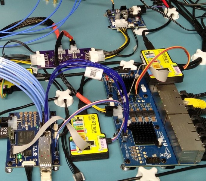

Our hacker [Andrew Zonenberg] reports in on his open-source high-speed Ethernet switch. He hasn’t finished yet, but progress has been made.
If you were wondering what might be involved in a high-speed Ethernet switch implementation look no further. He’s been working on this project, on and off, since 2012. His design now includes a dizzying array of parts. [Andrew] managed to snag some XCKU5P FPGAs for cheap, paying two cents in the dollar, and having access to this fairly high-powered hardware affected the project’s direction.

    1. Yep it’s a similar idea targeting the much lower end for in-chassis networking.
      My design is aimed at being competitive with e.g. a Cisco C9300L-48T-4G (1U, non PoE, 48x 1G edge ports) except I’m putting in dual 25G rather than quad 10G uplinks and omitting a lot of the firmware bells and whistles I don’t need (802.1x, IGMP, etc).
      I just want port VLANs, 802.1q, probably 802.3ad on the uplinks eventually, maybe some basic ACLs eventually, ability to force speed/duplex, TDR cable testing, performance counters, probably span analysis eventually, and SSH management – on a dedicated RGMII port that is (by design) not bridged to the fabric so you can have completely isolated management if you want.

    1. The alternative is to use switch ASICs where you have to sign an NDA and have a volume sales agreement to even get a datasheet. I started this project because going FPGA-based was the only way to have a properly OSH friendly switch, at least until open ASIC PDKs reach the point that gigabit SERDES IPs and large dies and FCBGA packages are viable. I don’t want to use NDA’d parts even if the stuff has leaked because I don’t want to give any money to people encouraging such business practices.
      And while the chip is close to $4K at Digikey, they can be had much cheaper if you don’t mind a sketchy overseas source that’s probably selling you a reball. LCSC currently has them for around $100 in qty 1 down to $85 in volume. At that point for a DIY/low volume build, the ten-layer PCB is going to be the dominant cost (probably high 3 digits USD for a batch even at my usual Shenzhen fab, close to $10K in the USA).

    1. I’ve been using $50 ebay’d Ciscos for a long time, but they don’t have 10/25G uplinks and I don’t exactly trust them as much as I’d like to given they weren’t purchased new. I had been planning to replace them “any year now” with my own designs since about 2015 (when they were already starting to get old) but I ended up taking longer to get to this point than I had hoped.
      The end goal of this project is mostly for fun and learning, but also to have a switch that I can trust as completely as possible without fabbing my own fabric ASIC, decapping a few at random, and diffing SEM images against the GDS.
      1. Also I forgot to mention, power is the other huge consideration.
        My current Ciscos pull about 150W each for 24 gigabit ports. Multiply by four and that’s a fair bit of juice.
        My FPGA design is targeting sub 50W for 48 ports, a 6x reduction in power. Cutting ~500W off my power bill will save me something like $70 a month in lab operating costs and substantially prolong my run time on UPS/generator during power outages, to say nothing of the environmental benefits.
