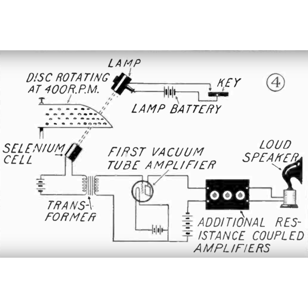

The instrument was called the Luminaphone and was originally built by [Harry Grindell Matthews]. Of course, this was an age before transistors and many other things we take for grated, so it has some quirks that we might not otherwise expect from a musical instrument. The device generated sound by shining a series of lights through a perforated rotating disc at a selenium cell. The selenium cell was an early photoresistor, generating current corresponding to the amount of light falling on it. A keyboard activated different lights, shining on areas of the disc with different numbers of holes, causing differing sounds to be produced by the instrument.
The recreation was built by [Nick Bild] and uses a laser diode as a stand-in for the rotating disc, but since it can be modulated in a similar way the idea is that the photodiode used as a receiver would generate a similar sound. The recreation sounds a bit like a video game from the 8-bit era, but with no recordings or original Luminaphones surviving to the present day we may never know how accurate it is. There are some other electronic instruments still around today, though, and plenty of ways of DIY-ing their sound like this project which recreates the tonewheels of the classic Hammond organ.

  1. A selenium cell responds much more slowly than a photodiode, so I suspect the original sound was quite different (probably closer to a sine than a square wave). Also, since the original docs show a colander-like “disk”, so it seems that there were multiple light paths, possibly further altering the sound.
    1. Makes sense. How about an LDR instead of a photodiode?
      It’s slower, I think. My next idea as a replacement is a solar cell as sensor.
  2. The technical and mechanical limitations of the instrument would have produced an entirely different sound compared to blasting a square wave out from an Arduino.
    Keying the lightbulbs on and off would, for example, produce a distinct attack and release function. How they managed to have multiple keys with apparently not enough hole patterns or lamps for each key is also a mystery – which suggests that they summed up different patterns to achieve the right number of pulses per second but not necessarily equally spaced – which would also have contributed to an unique sound.

      1. I think you missed the point. LEDs are (nearly) instant-on and instant-off, depending on the specific LED and circuit design of course, but even worst case “slow” phosphor coated types (like white LED) have times measured in like… 100 nanoseconds. Modern incandescent bulbs have a MUCH slower turn on / turn off time, depending on the filament. Keeping wattage the same, a lower voltage bulb will be slower than a higher voltage one. Ballpark figures a 220V 50W might reach full brightness in perhaps 25ms, while a 12V 50W one might take several hundred ms. Changing the wattage and with the same voltage does the same – a 220V 500W takes over a second to reach full brightness!
        And another complication is that the response time of a selenium cell is also much slower than a photodiode, a fast one perhaps in the 0.1ms time frame, I’m not exactly sure. I know they were used as the sensor in very early optical soundtrack for playing back sound from film projection, so those designs could certainly handle something in the khz range. But there were other types which were much slower, maybe more like 1-10ms. This is another form of analog filtering that would affect the final sound.
        The LED and photodiode musical instrument is certainly very interesting, but there is absolutely no way it sounds anywhere near what the original instrument sounded like.
        1. You’re right. Perhaps emulate the on/off time with a RC circuit? Would be worth testing – together with a spinning disk. It seems, the next project is in the queue ;-)
        2. My feeling is that the end waveform resembles a sine wave, but with flattened peaks. And the on/off characteristic of the lamps and the slowness of the selenium detector would give a mellow attack and decay. So I think that the sound would be quite mellow.

          1. It would also include light leaking in through adjacent rows of holes, so each key would be modulated by its neighbors, plus whatever ambient light you have. It might be quite rich in harmonics and beat tones.
    2. There definitely are enough lamps and hole patters for each key to have its own. Just eyeballing it I’d say he’s got a three octave range with a lamp for each note and a corresponding hole pattern.
  3. Okay, cool concept, but the I would not use the word “recreation”, as this is a bit overstretched.
    It’s like making spaghetti bolognese, but using shoe laces instead of pasta, red paint for the tomato sauce and rubber balls for the meat. Selenium cells are slow, real slow, this would affect the sound greatly, lightbulbs are slow, this would affect the sound envelope greatly. I hate to say it, but perhaps using a 555…
  4. I wish he would have built it like the original. I have a feeling it would sound a lot different. This just sounds like a square wave that’s been slightly low pass filtered. Using a 1920’s horn speaker would probably make it sound a lot different too.
  5. I wonder why the disc should be rotating at 400 rpm instead of 440 rpm. It must be a clue as to the spacing of the dots.
    Small calculation. Say that the circumference of the circle with holes on the disc is exactly 100cm (disc with a diameter of 31.831cm, which seems reasonable, looking at the pictures). At 400 rpm that would be 400 times 100cm per minute (40,000cm per minute), or 666.67cm per second.
    If I’m deducing and calculating correctly, to get a 400Hz tone, you would want to have 400 holes in those 666.67cm, or one hole every 1.16667cm.
    For a 440Hz tone, that would be 666.67/440 = 1.5cm between each hole. That’s a nice number. Although well, the placements of the holes is ‘analog’, so a hole every 1.666666667cm wouldn’t be much harder.

    1. I would be willing to bet that it was 400 rpm because he used an AC motor and a gear reduction that was available.
    2. If you’re running at 400 RPM you get closer to the correct frequencies with an integer number of holes around the circle.
      66 holes = 440 Hz (A)
