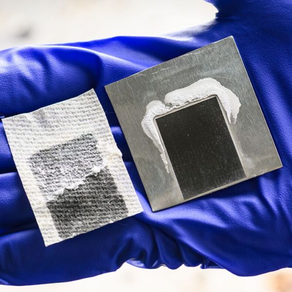

Although desalination is very commonly used these days to convert seawater into fresh water, one of the major disadvantages of current approaches is that commercial desalination plants produce a lot of brine, which has to be dumped somewhere ideally without causing major environmental issues. A new solar-thermal method as demonstrated by [Luheng Tang] et al. was published in Light: Science and Applications, with accompanying PR article.
This method is claimed to require no pre-treatment or leave brine, using special panels that wick water across their surface and then use solar radiation to distill this water. This differs from previous similar methods through a special surface treatment that prevents build-up of salts which would require cleaning or replacement.
The salts and other contaminants that would normally end up in the brine slough off these cells and can then be further processed to recover everything from plain table salt to lithium as well as gold, uranium and other substances of interest that are prevalent in seawater.
So far these self-cleaning cells have been tested with water from a number of oceans with a claimed 74% solar-to-vapor conversion efficiency and nearly 100% salt extraction. As always the challenge will be in scaling this up to industrial levels, but so far it looks promising.

  1. A very good development, however still requires the handling of salt. At scale, the best way will still likely require some sort of dilution / pumped disposal, and thus we are back to environmental challenges and brine, perhaps minus the important elements previously in solution.
    1. Given the amount of salt in rock form mined ending up with solid salts seems like a winner for everything but the salt miners.
    1. No. It’s only bad if you take the salt completely out of the ocean and then dump it back in. If you only take out the water but just leave the exact same quantity of salt behind then it doesn’t count. Stop being so anti-technology.
      1. It counts if you don’t disperse your salt over bigger area. Concentration of salt or salty return water is the problem, it creates hotspots of highly salty water. But dispersing over wider area means more pipes and pumps, which is more expensive to build and operate.

    There are ~135 grams of dissolved solids in every gallon of sea water of that 110 grams is Sodium Chloride. Globally, over 22,000 desalination plants produce roughly 25 to 35 billion gallons of fresh water every day. That works out to 1.4 billion metric tons of “table salt” per year if this technology merely replaced existing desalinization plant capacity.
    The problem is the world only consumes around 250 to 300 million metric tons of sodium chloride each year. The vast majority of which is used for large-scale industrial and commercial purposes
    The simple statement that “can then be further processed to recover everything from plain table salt to lithium as well as gold, uranium and other substances of interest that are prevalent in seawater.” seems to attempt to sweep this material under a rug of implied 100% utilization. A possibility the numbers simply cannot support.

  8. No desalination system is taking more salts out than it puts back in that same environment. You have a problem w/ that, drink salt water. Concentration removed = salt put back. No, this won’t bring peace of cure cancer, but it might save human life. Wells in groundwater that produce saline are already salty. If you remove x H2O, yes the salt left behind will return to salty water if it rains. Hint: the object was to extract water. If you want to save the salt in your basement, feel free, but you too are altering a many million year old environment, not the reverse.
  9. If the problem is to get rid of the salt, then one way is simply to let the brine concentrate up to near saturation, about 25%, then cool it to near 0 C. Its density (about 1.2 times fresh water) would let make it flow like a river underwater. So let it. Just pick a site where it will flow to a very deep trench or subduction zone. It will stay put.
    1. Cooling to 0 C is very energy intensive.
      The Claude “Bud” Lewis Carlsbad Desalination Plant in California produces 50 million gallons of drinking water PER DAY.
      Thats close to 15 Million pounds of salt every day, which would work out to 5 million gallons of 25% brine you would be chilling.
      San Diego’s ocean water averages 60°F to 70°F (15.5°C to 21°C) year-round. Assuming your desalinization process did not heat the sea water up at all, you would need To chill 4.8 million gallons of 25% saltwater brine from 18.25C to 0 C you will need a total cooling energy of approximately 376MWh. In sunny San Diego that would require between 75 and 110 acres of solar panels, producing enough electricity that could otherwise power around 12000 homes, wasted on chilling brine before dumping it.
      1. A large chiller has a COP of about 7, you’d pre-cool some amount by evaporative chillers, and the actual target is more like 4-5C for maximum density. So energy consumption to cool that to will be more in the ballpark of 50 MWh/d, about 5% of the total plant electricity consumption, and about two percent of the plant’s operating cost.
