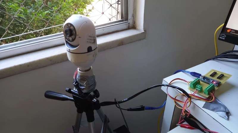

Camera is seen on the left with an Arduino connected to the right
Look To The Sky With This Simple Plane Tracker
Do you ever get tired of stressing your neck looking for planes in the sky? Worry not! Here is a neat and cheap Arduino/Ras Pi project to keep your neck sore free! [BANK ANGLE] presents a wonderfully simple plane tracking system using an affordable camera and basic microcontrollers.
The bulk of the system relies on a cheap rotating security camera that gets dissected to reveal its internals. Here stepper control wires can be found and connected to the control boards required to allow an Arduino nano to tell the motors when and where to spin. Of course, the camera system doesn’t just look everywhere until it finds a plane, a Raspberry Pi takes in data from local ADS-B data to know where a nearby plane is.
After that, all that’s left is a nifty overlay to make the professional look. Combining all these creates a surprisingly capable system that gives information on the aircraft’s azimuth, elevation, and distance.
If you want to try your hand at making your own version of [BLANK ANGLE]’s tracker, check out his GitHub page. Of course, tracking planes gets boring after a while so why not try tracking something higher with this open-source star tracker?

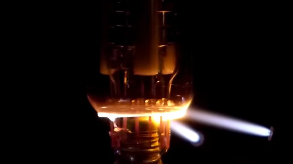

Plenty of readers will be familiar with CRT televisions, not least because many of us use them with retrocomputers and consoles. But perhaps fewer will have worked with CRTs themselves as components, and of those, fewer still will be familiar with the earlier generation of tubes. In the first few decades of color TV the tubes were so-called delta gun because their three electron guns were arranged in a triangular form. [Colorvac] has put up a video in which they demonstrate the reconditioning of one of these tubes from a late-1960s Nordmende TV.
The tube in question isn’t one of the earlier “roundies” you would find on an American color TV from the ’50s or early ’60s, instead it’s one of the first generation of rectangular (ish) screens. It’s got an under-performing blue gun, so they’re replacing the electron gun assembly. Cutting the neck of the tube, bonding a new neck extension, and sealing in a new gun assembly is not for the faint-hearted, and it’s clear they have both the specialist machinery and the experience required for the job. Finally we see the reconditioned tube put back into the chassis, and are treated to a demonstration of converging the three beams.
For those of us who cut our teeth on these devices, it’s fascinating.
