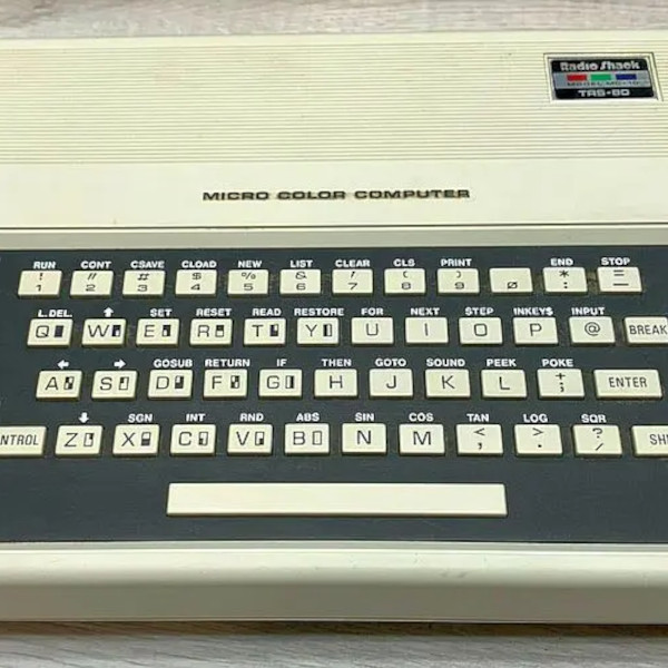

As [David] explains in his deep dive into this somewhat obscure machine, the TRS-80 MC-10 was a commercial failure, although not for want of features. It had a color display, a chicklet keyboard, and 4K of RAM, which were all things that the ZX-80 lacked.
Unfortunately, it also had a number of drawbacks compared to some of its other contemporaries that made consumers turn away. Other offerings by Commodore, Atari, Texas Instruments, and even RadioShack themselves were only marginally more expensive and had many more features, including larger memory and better storage and peripheral options, so most people chose these options instead.
The TRS-80 MC-10 is largely a relic of the saturated 80s home computer market. It’s drop in price to below $50, and the price competition between other PC manufacturers at the time was part of the reason for the video game crash of the 1980s, and even led to Steve Jobs getting fired from Apple. There’s not a huge retro scene for these machines either, although there is at least one game developer you can see in the video below from [Spriteworx]. If you want to experiment with some of the standard TRS-80 software, there are emulators that have everything you need.

  1. The MC10 is an interesting machine, it has a decent CPU , the MC6803 but the design was weird. The MC6803 has a serial port but the designers of the MC10 decided not to use it. Instead they bit banged the serial like the CoCo series. That was not the only trade off. Shame, it actually isn’t a terrible machine but it wasn’t up to the standards of the time.

    2. This is a membrane keyboard, not a chicklet keyboard. Very different and much worse. My fingertips ache whenever I even think about my old Atari 400.

    Chicklet keyboards were widely despised and that’s why computer companies stopped using them. IBM realized they made a grave error by releasing the PC Jr with a chicklet keyboard.

  9. I think i found why they didn’t use the built in serial. The supported baud rates the 6803 could support were tied to the chips clock speed.
    It appears that motorola was expecting 1.22mh to be the base clock and at that cpu speed it supports the common bauds of 300,1200 and 9600 but if rs was using the 1mh speed option the available bauds were odd numbers like, 244.1, 976.6 and 7812.5
    It may have been too much of a headache to find printers or modems that would work with it at those speeds. Even if they didn’t plan on releasing many add on’s their own I internal development tools would probably break on these rates.
