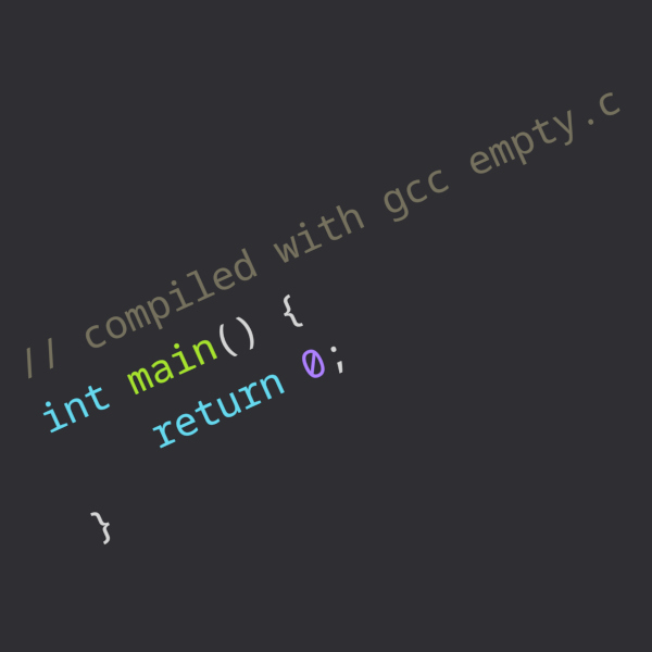

It’s well known that the difference in executable size between a compiled binary and one hand-written in optimized assembler will be significant. The compiler brings in all manner of boilerplate whether it needs all of it or not, which is responsible for the extra space. [Weineng] has fallen down the rabbit hole of trying to make the smallest possible gcc-compiled C executable, and the resulting write-up is a fascinating read.
Surprisingly the smallest C program isn’t “Hello World”, but one which simply does nothing but return 0. This results in a binary weighing in at a surprisingly large 15,816 bytes — something which surely could be improved. There follows a set of clever compiler flags and bits of code manipulation to remove some debugging information, and strip out unnecessary stuff executed before void main().
At 13,632 bytes it’s still a little on the chunky side, so it’s time to examine what libraries it brings in. More compiler flags get it down to 8,704 bytes. Removing a code comment section and error handling with more flags takes it to 4,320 bytes. Then there’s code which dictates how memory is allocated, which brings it down to 400 bytes. That’s an impressive reduction!

    1. The actual code for main() {return 0;} is only a few bytes. Where it gets larger is using the standard libraries that get linked in (even for statically linked). I assume that the flags used to create the smallest versions just bypass that altogether and effectively have a start location pointing to set result to 0, clean the stack (if that’s necessary) and return, which is what you’d do in assembly.

  6. “Removing a code comment section”. Comments are never compiled so I don’t see how this could make the executable smaller.
    1. Turns out, the .comment section stores the compiler used to create the binary and in our case, GCC: (GNU) 15.2.0
      there’s a thing called “reading the actual article”. Try it sometime. It’s fun!
  7. “4,320 bytes. Then there’s code which dictates how memory is allocated, which brings it down to 400 bytes”
    Can someone tell me; would the program still work without me allocation?
    1. It wouldn’t, since the allocations in question are how the ELF is actually loaded into memory as well. In the article itself, it’s stated more clearly. A complicated scheme of many memory allocations/loads is replaced with a single memory load for all metadata and the .text section.
