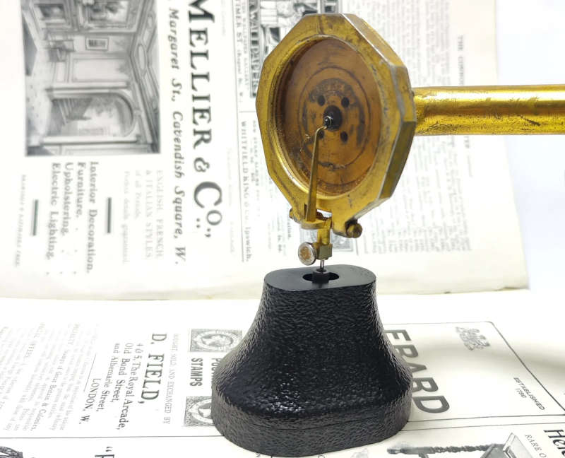

So you happen to have a gramaphone– maybe a big old Victrola/HMV, perhaps a Columbia– regardless of brand, it’s a big, beautiful conversation peice for your living room. It might not be the most practical listening device, since isnomuch as there is a vinyl renessance, it’s restricted to vinyl, not the old shellac 78s the these all-mechanical beasts were born for. [JGJMatt] decided to bring his gramophone into the 21st century, turning it into a bluetooth speaker without altering any of its original internals.
What’s really interesting is that this hack was once a commercial product– sort of. Back in the 1920s when everyone was listening to Jazz, the problem of ‘ what do I do with this massive gramophone cabinet when I’m not cutting a rug?’ was equally valid, and a solution was found: the Dulce-Tone Radio Speaker. A very weak speaker sits under the needle, turning the gramaphone mechanism into an amplifier for the radio. The very same concept, [JGJMatt] would work equally well in the 2020s with a bluetooth signal as in the 1920s with an AM one. There’s no demo video for this project, but you can hear how its 1920s inspiration sounded in the video below.

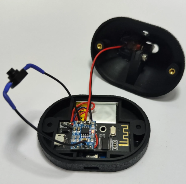

The driver for this device is made using a neodymium magnet and the voice coil from a 3W speaker. A 3D-printed needle-holder captures the gramophone’s needle– a much thicker and sturdier thing than the tiny diamond-tip you’d find on a modern turntable, we should note– and holds the magnet to it. The voice coil gets driven via a MH-M38 bluetooth module, and everything is held in a nice 3D-printed case along with the battery.
The hack is, of course, totally reversible: at any moment, you can remove the needle from this device and drop it on a 78 for some Jazz-era fun, or swap back for 21st century brainrot. If you happen to have some of those old shellac records and a modern turntable, note it takes more than the right RPM to get good sound.
