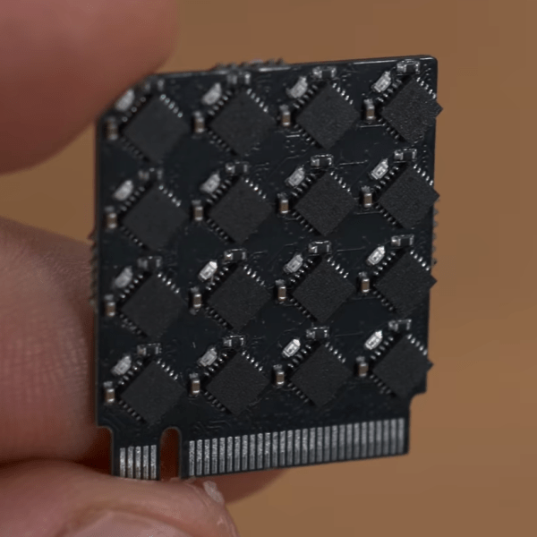

Aside from GPUs, you don’t hear much about co-processors these days. [bitluni] perhaps missed those days, because he found a way to squeeze a 160 core RISC V supercluster onto a single m.2 board, and shared it all on GitHub.
OK, sure, each core isn’t impressive– he’s using CH32V003, so each core is only running at 48 MHz, but with 160 of them, surely it can do something? This is a supercomputer by mid-80s standards, after all. Well, like anyone else with massive parallelism, [bitluni] decided to try a raymarcher. It’s not going to replace RTX anytime soon, but it makes for a good demo.
Like his previous m.2 project, an LED matrix, the cluster is communicating over PCIe via a WCH CH382 serial interface. Unlike that project, blinkenlights weren’t possible: the tiny, hair-thin traces couldn’t carry enough power to run the cores and indicator LEDs at once. With the power issue sorted, the serial interface is the big bottleneck. It turns out this cluster can crunch numbers much faster than it can communicate. That might be a software issue, however, as the cluster isn’t using all of the CH382’s bandwidth at the moment. While that gets sorted there are low-bandwidth, compute-heavy tasks he can set for the cluster. [bitluni] won’t have trouble thinking of them; he has a certain amount of experience with RISCV microcontroller clusters.

If you need to give up trace thickness for power/ground routing, probably the better trick is to jump them around using 0-ohm resistors so you’re buying yourself an extra layer while maintaining copper thickness. There’s a reason why you buy 0-ohm resistors in reels.
This is not clear. The pads on the PCB for a resistor are always larger than the resistor. How can you gain something if you need a large area to solder it? Or do you mean using through hole resistors? (In that case, a dumb wire is better, no?)
No, the trick he’s referring to is when two traces are trying to cross perpendicularly but they’re on the same layer, you use a 0ohm resistor as a jump for one of the traces: so one trace goes straight through the intersection, the other jumps over it with the resistor (with one pad on each side of the other trace). It’s layers without the actual layers.
This is such an elegant solution that I now genuinely feel slow for not utilizing it before now. Thank you.

The final product even looks very nice, with that even grid of 45-degree diamond-shaped chips. Very slick
What I love most is the entire cluster consumes 4 Watts.
Yup, a very common problem with massively parallel architectures. It’s a big headache transporting data off-chip with other nodes at speeds that can keep up with the compute. That’s why there’s specialized networking technology like InfiniBand.
