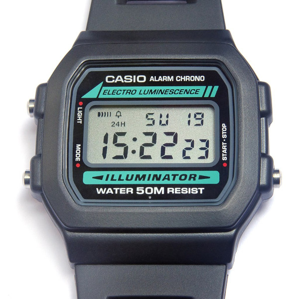

  1. Looks like Casio F-91W – this watch fits for Man and Woman, and I think every hacker/maker should have one! It is a good starter at least. There are even mods for this watch. I had one and switched to Casio Royale with all metal mod from AExpress.

    2. I think it’s Casio W86. I was recently planning to buy F91W and this looked slightly different.
      But agree that those are great value and very versatile watches. Only wish they put metal buckle – this plastic prog tends to go through frame under bit of force (almost lost my W800 this way).
