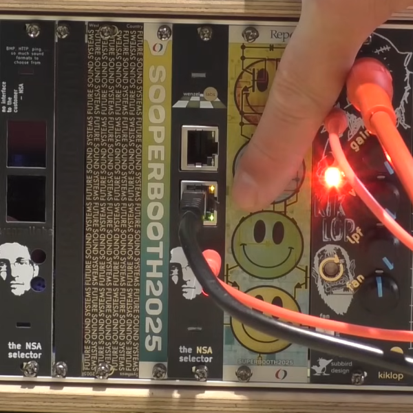

Ethernet is how we often network computers together, particularly when they’re too important to leave on a fussy WiFi connection. Have you ever thought about listening to Ethernet signals, though? Well, you totally could, with the NSA selector from [wenzellabs].
The NSA selector is a Eurorack module, designed for use as part of a larger modular synthesizer. There are lots of fun jokes and references on the PCB, but the front panel really shows you what this module is all about. It’s got a pair of RJ45 jacks, ready to receive your Ethernet cables through which data is flowing. They’re paired with a single audio output jack. “Any bit on the network will be sent to the audio output,” [wenzellabs] explains.
The device operates in a relatively simple fashion. Network traffic from one jack is forwarded to the other, unmodified. However, it’s also spat out to a simple digital-to-analog converter and turned into audio. This thing doesn’t play digital audio formats or anything like that—it just turns raw Ethernet signalling into audible noise.

  3. Anything going over the network is likely to be fairly efficiently coded, meaning by definition that payload data will sound like white noise. Any tonality you hear will come from regularly repeated bit patterns, which is just going to be the frame and packet headers, which will be at a fairly constant pitch. I guess TCP congestion might cause the pitch to vary in some cases, but for the most part you’ll just hear a screeching when there’s traffic and silence otherwise.
    Which is still interesting, and I bet you could learn to hear things like how much strain an HTTP server is under. But it makes me wonder if there are simple ways to process the signal that would expose more information and/or make nicer sounds.
    Like say, have inbound and outbound frames trigger two different (micro)samples. Or maybe have a range of microsounds mapped to the source and destination fields in IP headers, so you’d hear a difference between different connections. I’m quite keen to try this now I think about it.
