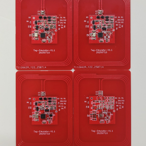

Most of you know how an NFC tag works. The reader creates an RF field that has enough energy to power the electronics in the tag; when the tag wakes up, two-way communication ensues. We’re accustomed to blank tags that can be reprogrammed, and devices like the Flipper Zero that can emulate a tag. In between those two is [MCUer]’s power-free tag emulator, a board which uses NFC receiver hardware to power a small microcontroller that can run emulation code.
The microcontroller in question is the low-power CW32L010 from Wuhan Xinyuan Semiconductor, a Chinese part with an ARM Cortex M0+ on board. Unfortunately, that’s where the interesting news ends, because all we can glean from the GitHub repository is a PCB layout. Not even a circuit diagram, which we hope is an unintended omission rather than deliberate. It does, however, lend itself to the fostering of ideas, because if this designer can’t furnish a schematic, then perhaps you can. It’s not difficult to make an NFC receiver, so perhaps you can hook one up to a microcontroller and be the one who shares the circuit.

The emulator currently supports ISO/IEC 15693 emulation with full compatibility for read/write operations, and ISO/IEC 14443A support is in development.
It is an NFC Tag Emulator, so it emulates 13.56MHz tags, not 125KHz ones. The current hardware version is V1.1. I will continue to improve it and release the schematic diagram and Gerber files in due course.
Please carefully watch the video on GitHub. This video uses the mobile app TagInfo to read the content of the tag. As is well known, mobile phones do not have 125KHz RFID hardware. Therefore, it works at 13.56MHz rather than 125KHz.
From the pictures, it looks like the BOM and Gerber can already be generated, at least in draft form. Is there a reason not to check them in as a baseline?
The current version only supports simulating one Tag. The next version will add a button and a three-color LED to switch between multiple Tags. Once the firmware for simulating the 14443A Tag is completed, the BOM and Gerber files will be released together.

https://github.com/NFC-funs/Power-free-NFC-Tag-Emulator
Do you plan to release firmware, schematics and gerber files?
When I finish the ISO-14443A part, I think I will release it.
I have uploaded the Gerber files and BOM to GitHub.
Added a DIP switch
Based on Version 1.1, the hardware has been adjusted with some components reduced. A DIP switch has been added to select between emulating 14443A or 15693 tags, with support for 8 tags for each type.
The firmware supports emulation of Ntag215 and ISO 15693 tags.
Do you have a repository for the firmware source code? I can’t find it anywhere (I’m sure it’s not PN532Killer).
I will release a firmware that emulates Ntag21x and 15693 in the near future.

The first firmware version was released

Hardware V1.3:
Switch tag slots by pressing SW2 and/or SW3;
Enter the settings mode by pressing SW1;
Add a status indicator LED;
Firmware supports MIFARE 1 emulation.
