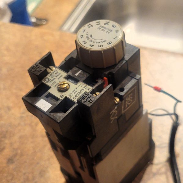

These days, if you want to flash some LEDs, you’d probably grab a microcontroller. Maybe you’d go a little more old-school, and grab a 555. However, [Jacob] is even more hardcore than that, as evidenced by this chunky electromechanical flasher build.
[Jacob] goes into great detail on his ancillary write-up, describing how the simple building blocks used by industrial control engineers can be used to make a flasher circuit that cycles once per second. Basically, two relays are paired with two 0.5-second delay timers. The two relays tag each other on and off on delay as their timers start and expire, with the lamp turned on and off in turn.

  3. Hi Lewin! Thanks for showcasing my project on the blog! Its an honor! I’ve been reading the blog for over a decade now. There’s lots of really smart people on these parts of the internet. Shout out to Peter and his relay CPU! That things amazing!
    I thought this would be an interesting solution going into the contest. Most of the projects on Hackaday tend to be more on the embedded hardware and software side. Working in industrial controls our solutions to tend to be over built and more expensive. When you are making machines that make machines cost is less of an issue, and up-time is very important. They’re designed so Bob in the maintenance department can fix the thing with a screw driver without specialized training or tools like SMD soldering or an oscilloscope.
