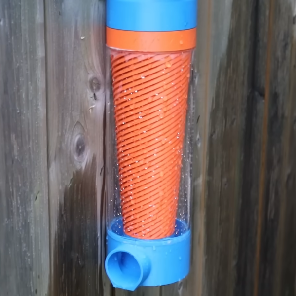

No one likes cleaning out water spouts. [NeedItMakeIt] wanted to collect rainwater and was interested in using a Coanda filter that those used on hydroelectric plants to separate out debris. Ultimately, he decided to design his own and 3D print it.
The design uses a sloping surface with teeth on it to coax water to go in one direction and debris to go in another. It fits into a typical spout, and seems like it works well enough. Some commenters note that varying volumes of rain and different types of debris behave differently, which is probably true. However, there are similar commercial products, so you’d guess there would be some value to using the technique.
The water pushes the debris off the slope, so you end up losing a little water with the debris. So as always, there’s a trade-off. You can see in the video that if the water flow isn’t substantial, the debris tends to stall on the slope. Could the filter be improved? That was the point in trying a second design.
It wasn’t a big improvement. That’s where there’s a plot twist. Well, actually, a literal twist. Instead of making a flat slope, the new design is a conic shape with a spiral channel. That improved flow quite a bit. We weren’t clear from the video of exactly where the debris was going with the last version.

  1. We weren’t clear from the video of exactly where the debris was going with the last version.
    The crap falls straight through and goes down the rest of the downspout, presumably to the sewer connection. The idea is to pick off clean water to collect in a rain barrel while letting the crap get flushed away.

  7. To all those asking questions, this device is a separator, not a filter. He’s separating the water from the debris, saving the water for his plants, and letting the debris fall through to the ground where it dries up an blows away.
    In a filter, all of the flow goes through the filtering mechanism.
    In a separator like this, some of the flow is diverted, and some flow is left to clean the grating and keep it from becoming clogged.
