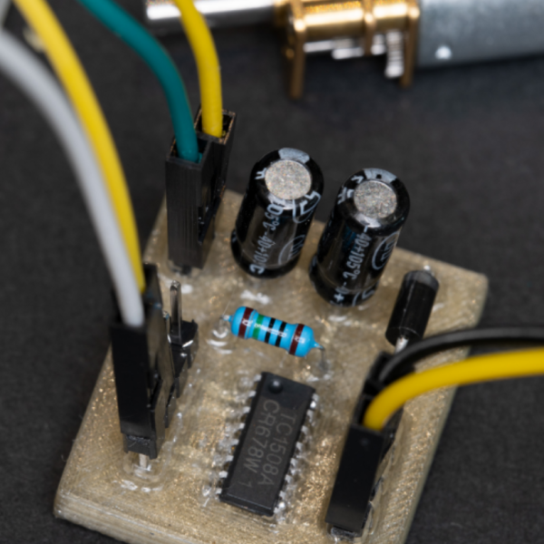

A brown plastic circuit board is visible in the middle of the picture, containing an integrated circuit, a resistor, a diode, two capacitors, and some jumper wires going away to the sides.
Anyone who’s spent significant amounts of time salvaging old electronics has probably wished there were a way to take apart a circuit board without desoldering it. [Zeyu Yan] et al seem to have had the same thought, and designed circuit boards that can be dissolved and recycled when they become obsolete. Read the details in the research paper. (PDF)
The researchers printed the circuit boards out of water-soluble PVA, with hollow channels in place of interconnects. After printing the boards, they injected a eutectic gallium-indium liquid metal alloy into these channels, populated the boards with components, making sure that their leads were in contact with the liquid alloy, and finally closed off the channels with PVA glue, which also held the components in place. When the board is ready to recycle, they simply dissolve the board and glue in water. The electric components tend to separate easily from the liquid alloy, and both can be recovered and reused. Even the PVA can be reused: the researchers evaporated the solution left after dissolving a board, broke up the remaining PVA, and extruded it as new filament.
The researchers designed a FreeCAD plugin to turn single or multi-layer KiCad circuit layouts into printable files. They had to design a few special sockets to hold components in place, since no solder will be fastening them, but it does support both SMD and through-hole components. The traces have a bit more cross-sectional area than normal copper traces, which has the advantage of compensating for the liquid alloy’s higher resistance; their standard traces had no trouble dissipating heat when carrying 5 amps of current. As a proof of concept, they were able to make a Bluetooth speaker, an electronic fidget toy, and a flexible gripper arm.

    1. We have not observed any issues with embrittlement with the EGaIn for the duration of the study. We do in fact take advantage of the oxidation of the liquid metal to control viscosity for injection, which helps with handling.
        1. Yes, that is a valid question! However, we use min trace width of 0.75 mm, which is on the larger side of things for PCBs, which is able to carry a good bit of current. Furthermore, as the traces are true 3D (min. 0.75 mm x 0.75), unlike traditional PCBs that use thin copper layers (2oz, for example), we are actually able to handle a lot of current. In the paper we discuss temperature change (as is the effect of resistance, of course) as we put current loads on the circuit. We are able to handle 5A comfortably with the min. trace width!
  1. Interesting idea, but how long can this actually hold? Any crack could lead to the liquid metal spilling, and there’s no easy way of fixing the board once it does, save for complete rebuild.

    2. Actually, the assembly is quite solid and durable. It is able to absorb a good amount of impact since it is plastic (PVA, specifically). If there is a small leak, a bit of PVA glue, as used in the initial assembly, would be all that is needed to fix such issues. As for bigger cracks/damages, I would say that traditional FR-4 based PCBs wouldn’t fare much better with the required forces for such damages to occur. Here, the advantage of DissolvPCB is that it is fully recycleable and supports component reuse, unlike traditional PCBs in case it DOES break!
      There is probably a lot more work to be done for this process to be commercialized, but this process is mostly aimed towards makerspaces (hopefully a lot of you guys!) with limited facilities and equipment.
      The liquid metal we use, Eeutectic Gallium Indium (EGaIn), remains liquid at room temperature, and has a very high surface tension. We oxidize the EGaIn to a certain degree to add viscosity for easier handling and injection, actually, no need for heating/cooling. After assembly, we use PVA glue made from recycling previous DissolvPCB boards to glue down the components in place and hold in the liquid metal as well. It is quite solid, although it can become flexible/bendy in humid environments.
  2. Yeah. I wonder about durability. I expect many of us have experienced having our glasses fog up upon stepping out the door on a warm humid day. Just imagine a soluble device and you need to carry it from house to car or any other reason you would move it from household temps to outside and warmer moist air, repeatedly

    1. Compare it to a breadboard in the same situation. If the PVA board springs a leak, you can’t miss it. Bumping a component on a breadboard during transport may not be immediately obvious if the part isn’t dislodged.
      Breadboards may also be unsuitable for some circuits due to their capacitance issues, where the PVA board may not.

      1. This is a great reply! Yes, it does have concerns with humidity/moisture damage. (Although it is plastic, so doesn’t really have the ‘fogging’ effect but humitidy/water is definitely a concern) If left in a humid environment, the DissolvPCB tends to get a bit flexible and bendy, although that has no impact on its performance (another advantage of liquid metal traces!).
        Regardless, this methods is indeed a great way (or at least a step towards) sustainability in makerspaces with no access to PCB fabrication methods and/or a good alternative to support material and component reuse.
        And as for the material PVA itself, its is only one of the many materials that could have been used. If a more permanent assembly is desired, something like PLA would totally be possible. Alternatively, there are 3D (or resin) print materials commercially available that have solvents like Alcohol, which would prevent the moisture/water damage. However, PVA does have its advantages in that the recycling is much easier and hassle free.
