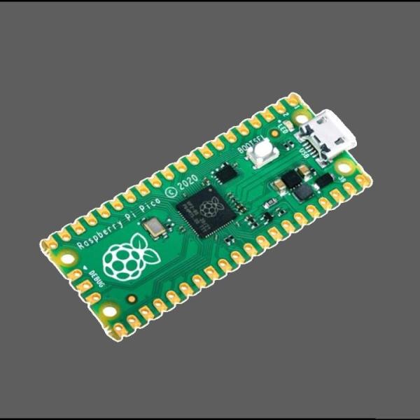

A photo of an RPi and a note about the first lecture.
ECE 4760/5730 is the Digital Systems Design Using Microcontrollers course at Cornell University taught by [Hunter Adams]. The list of projects for spring this year includes forty write-ups — if you haven’t got time to read the whole lot you can pick a random project between 1 and 40 with: shuf -i 1-40 -n 1 and let the cards fall where they may. Or if you’re made of time you could spend a few days watching the full playlist of 119 projects, embedded below.
