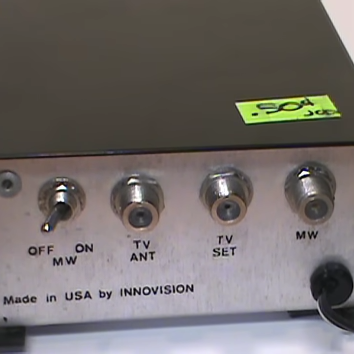

[VWestlife] ended up with an obscure piece of 80s satellite TV technology, shown above. The Micro-Scan is a fairly plan metal box with a single “Tune” knob on the front. At the back is a power switch and connectors for TV Antenna, TV Set, and “MW” (probably meaning microwave). There’s no other data. What was this, and what was it for?
Satellite TV worked by having a dish receive microwave signals, but televisions could not use those signals directly. A downconverter was needed to turn the signal into something an indoor receiver box (to which the television was attached) could use, allowing the user to select a channel to feed into the TV.
At first, [VWestlife] suspected the Micro-Scan was a form of simple downconverter, but that turned out to not be the case. Testing showed that the box didn’t modify signals at all. Opening it up revealed the Micro-Scan acts as a combination switchbox and variable power supply, sending a regulated 12-16 V (depending on knob position) out the “MW” connector.
So what is it for, and what does that “Tune” knob do? When powered off, the Micro-Scan connected the TV (plugged into the “TV Set” connector) to its normal external antenna (connected to “TV Antenna”) and the TV worked like a normal television. When powered on, the TV would instead be connected to the “MW” connector, probably to a remote downconverter. In addition, the Micro-Scan supplied a voltage (the 12-16 V) on that connector, which was probably a control voltage responsible for tuning the downconverter. The resulting signal was passed unmodified to the TV.

This box is not for sat tv, its for early “cable TV” that was beamed over microwave.
I remember the kits in the back of electronics magazines that would let you decode a service called “Wometco Home Theater” WHT, the movie network. As cable became more popular and widespread, over the air scrambled TV services faded into history.
Looks to me like the control box for a pirate MMDS receiver, AKA “wireless cable”. It was a pay TV service that was sent unencrypted via microwave in the 80s. We had it in Houston back in the day. Pirate boxes were very popular for receiving it, since it included XXX movies after 10:00 PM.
My suspicion as well. We also had this kind of “Wireless cable” in the Tampa area. Service was called Videotron. I believe it transmitted in the 2.3ghz band and carried a few dozen channels. The antenna was a directional yagi and the antenna included a down converter to downconvert the 2.3ghz channels into UHF channels you turned on your TV. Sprint bought the chunk of spectrum they used for this to deploy their failed WiMax service on.

The circuit shown inside this box appears to be a bias-T that powers an LNB (“Low Noise Block” downconverter) for terrestrial MMDS broadcasts popular back in the day. The “Tune” knob is likely part of a varactor-tuned VCO, and turn the knob and vary the oscillators voltage and thus change the frequency. Likely this drives the mixer LO (local oscillator) as part of the downconveter inside the LNB and voila, you can tune in different MMDS bands. Geeking out here…fun stuff and takes me back to the early 80s and my teenage years.
