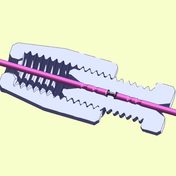

We’ve all done it at some time — made an electrical connection by twisting together the bare ends of some wires. It’s quick, and easy, but because of how little force required to part it, not terribly reliable. This is why electrical connectors from terminal blocks to crimp connectors and everything else in between exist, to make a more robust join.
But what if there was a way to make your twist connections stronger? [Ibanis Sorenzo] may have the answer, in the form of an ingenious 3D printed clamp system to hold everything in place. It’s claimed to result in a join stronger than the wire itself.
The operation is simple enough, a spring clamp encloses the join, and a threaded outer piece screws over it to clamp it all together. There’s a pair of 3D printable tools to aid assembly, and a range of different sizes to fit different wires. It looks well-thought-out and practical, so perhaps it could be a useful tool in your armoury. We can see in particular that for those moments when you don’t have the right connectors to hand, a quick 3D print could save the say.

  1. in the video, it wasn’t the solder joint that broke, but the wire after the solder joint that broke, probably because of being flexed. I would be interested in looking at the wires up close after stripping to see if he nicked any of the strands.
    But still, nice for temporary work. I use Wagos though.
    1. Solder wicking up the wire and creating a flex point (which metal fatigues) is the reason soldered joins are frowned on in any space w vibration issues (cars, airplanes, you mom’s…)
      Best reason to use crimped joins and to get a decent quality crimper.
    2. I don’t think I have ever seen two wires soldered together coming apart at the solder joint itself, whether the wires were twisted together and soldered or just soldered side by side, as long as a significant amount of solder actually adhered to the wires. It’s always been a failure right beside the solder joint. That said, the 3D splice will help with such failures by keeping the wire rigid in the area where the wire is not protected against hard bends with insulation. Heat shrink can do a similar thing.
      1. Solder causing a ‘hinge’ where any movement concentrates the metal fatigue into one spot is the reason why there are numerous automotive and aeronortical wiring standards that require crimped rather than soldered joints. It’s also why the folk wisdom of ‘belt and braces – add solder to crimped joints’ is so harmful
        1. How does crimping not create a hinge area? I’ve, wrongly apparently, always assumed the dislike of solder in cars and such was because of solder cracking or something along those lines. Surely it must be a heat related thing.

          2. The main knock on soldered connections in most wiring standards is that if the connection is just soldered and it gets heated enough, from its own current or another source, it can separate. The second knock is that it takes more time and skill to make a good solder joint than to crimp (assuming good crimp connectors and a properly set-up controlled-cycle crimping tool).
            I don’t think this new screw-together idea is an improvement on what we currently have. It looks pretty unforgiving on the wire diameter, and is slower to complete than crimping.
        2. This solder vs crimp holy war always comes up – while it’s true crimp is favoured for speed & ease of inspection as well as tolerating vibration more easily, a solder joint that’s then heat-shrunk to protect it can also be perfectly robust.
          There’s NASA standards as well as numerous other very critical applications where crimp or solder are allowed as long as proper processes are followed for each. It’s the proper process that is the real key.
          Crimp has the edge in industry because it is more idiot-proof to give people a calibrated crimp tool and proper crimps than a soldering iron, and you don’t have the associated risks around heat, fire risk, solder smoke, lead, etc.

  4. This is chasing the rabbit. Electrical wiring should never be under tension. What counts in an electrical joint is low resistance and that is a function of pressure over area. This device minimizes connected area and seems somewhat critical of joint makeup. Being 3D printed means it that as the join heats under load, the connection loosens ending in a cascade failure.
    1. Any power grid wire hung between towers or poles is under tension, although in some cases a steel core may take most of the mechanical load. The same applies to long wire antennas.

    Although I do like the effort put into it, the conclusion “stronger than a solder joint” is simply not true although if you don’t know how to make a decent solder joint than it might be true though.
    The real problem is not the connection itself, but strain relieve and bend radius.

  11. This works great when you have access to the end of the wire. But if there’s a big connector on both ends or it goes up into a wall or something, then it doesn’t work. Perhaps an improvement would be that the wire could slot into the joiner, or have two halves that can come together. It is necessary for 360 degrees around the wire to be held?
  12. I don’t get it. This doesn’t make sense to me because, for all that faffing about, the two wires are still in a straight line butted up against each other.
