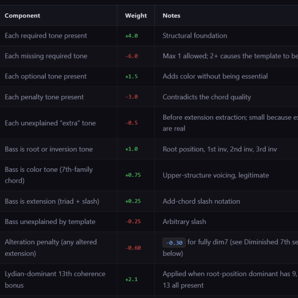

The problem with classifying chords is that the way musicians use them and construct them can be quite varied. Names can also be applied somewhat differently depending on the musical context of a given set of notes. To suit the musical reality of real players and composers, WhatChord uses a specially-developed scoring algorithm to try and nut out what a chord is actually supposed to be.

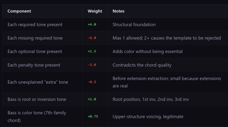

As an example, a major chord must require a root note and a major third interval. It can optionally include a perfect fifth. However, if there is a minor third, minor seventh, or major seventh present, then you’re almost certainly not looking at a simple major chord. WhatChord takes these things into account by weighting the different tones present and seeing which chord gets the highest score. The required notes add weight, while notes that shouldn’t be there add a penalty to the score. Then there are extra penalties for ambiguous “unexplained” tones, extensions, and a few other parameters to disambiguate edge cases.

  4. i feel like it’s a mountain out of a molehill. It’s an easy skill to learn and it’s not computatinally complicated if you are given a list of simultaneous notes. All of the sophistication is to recognize its role, to recognize the chords it suggests or the way it relates to the notes before and after.
    Like if it is given C# E, by the decision matrix above, that’s C# minor with certainty +9 (required tones present 2x+4, bass is root +1). And it’s A major with certainty -1 (1 required tone present +4, 1 required tone absent -6, bass is inversion +1). And it’s Emaj6 or Emin6 +0.5 (1 required tone present +4, 1 required tone absent -6, bass is root +1, optional tone present +1.5?).
    As a musician, i’m going to interpret those two notes as roughly equally suggestive of all 4 of those chords. I’m not going to consider C# minor to be at all more likely than Amaj. But in the context of a specific piece, i’m likely to pick one or two of them with some confidence. My point is, that more holistic process is the only way to at all understand the chord, and doing it intuitively (and internally) and embracing the ambiguity is the only way to develop an understanding of the role of chords in music.
