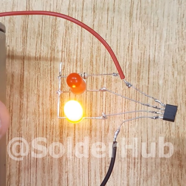

A photo of the air-wired circuit, with one LED on and the other off.
Recently, [Solder Hub] put together a brief video that demonstrates the basics of a Hall Effect sensor — in this case, one salvaged from an old CPU fan. Two LEDs, a 100 ohm resistor, and a 3.7 volt battery are soldered onto a four pin Hall effect sensor which can toggle one of two lights in response to the polarity of a nearby magnet.

  1. This is a good example of how not to use an 18650. It wouldn’t take much to short the positive wire to anywhere on the exposed case and give yourself a bad day.
    Heatshrink is cheap.
    1. dear god! i’m always so anxious when i am hooking up a lithium battery (usually soldering on its pigtails). but i only do it when i actually need a battery! if all i want is a bench supply for my experiments…i use my bench supply
      treating a battery this way is such aggressively worst practices that i am now on the side of this should be banned from youtube, definitely not re-blogged by hackaday! there’s arguably a lot of value in showing the minimal reference circuit, but totally gratuitous danger as part of the demo is not just a little bit wrong. specifically for the people who wouldn’t automatically envision this demo in their head when they see the schematic at the end of the datasheet, this sets an example they might actually follow!
      and to top it off, it’s not even an easy thing to do! any newbie attempting to play this same game at home after watching the video will find the step of trying to solder on a cell to be extra frustrating!

    And I saw at least one small but useful hack: extend component leads to reuse an existing component.

    For instance this video taught me 4 pin hall effect sensors exist too!
