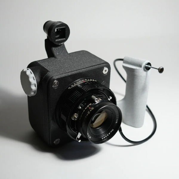

For those who wish to take their film photography further there’s the so-called medium format 120 roll film, but here opting for a higher-end camera can become expensive. Fortunately [Javier Doroteo] is here with a 3D printed medium format camera designed to use lenses intended for the Mamiya Press cameras, and from where we’re sitting it looks very nicely designed indeed.
All the files can be found on Printables along with a list of the other parts required. It’s made simple by the Mamiya lenses incorporating the shutter, but there’s still a lot of attention that has been paid to the back of the camera. This is the third version of the design and it shows, details such as the film holder and light proofing are well thought out.
Photography is so often a world in which collecting the latest kit is seen as more important than the photographs themselves, so we like and encourage camera hackers as a reaction to all that. If you’d like to see another medium format camera, this certainly isn’t the first we’ve brought you.

  1. This is much more compelling than the other 3D printed medium-format cameras I’ve seen over the years.
    Most of the others require you to supply the lens, lens mount, and camera back from an actual camera. For those unfamiliar with the design of medium-format cameras, this is just about every interesting part of the camera. “Using nothing but some 3D printed parts, some machine screws, and a medium-format camera, our clever hero builds a medium-format camera!”
  2. Mamiya press bodies are incredibly affordable. This also looks like a 6×6, which is definitely a step down from press’ glorious 6×9 back. Also zone focus vs rangefinder. :(
    Source: i have a mamiya press universal. It’s a beautiful beast!

  4. Seriously, purchasing a Kiev 60 (Pentacon Six copy) kit and few lenses would still be cheaper than buying a good 3D printer and filament to manufacture a dodgy prototype camera at home with, if you really wanted to get started with a decent medium-format camera.
    Even cheaper would be a TLR camera, if interchangeable lenses weren’t your thing.
    Both options would have less opportunity for disappointment caused by bad framing and focus, than a box camera with uncoupled viewfinder.
    1. Maybe use two of the few 50mm lenses from SLR era to build a medium format TLR ?
      The thing with DIY is by the time you are custom building something, you might as well go large format where simple lenses built from a few files elements doesn’t seem all that bad and even pinhole seems decent, why medium format?
  5. A TLR is pretty cheap, potentially cheaper than printing this and sourcing a lens. Or at least was when I bought mine – prices may have gone up.
