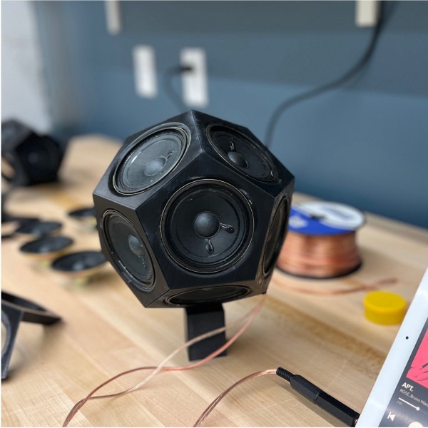

Once upon a time, many radios and TVs only came with a single (mono) speaker. Then someone decided all audio hardware should have as many speakers as we have ears. That was until [Olivia] came along, and whipped up a dodecahedron speaker as an educational piece for workshops. Really, it shows us that twelve speakers should be the minimum standard going forward.
The speaker relies on a 3D-printed frame. The dodecahedron shell is assembled from 12 individual faces, each of which hosts a small individual speaker. Multichannel audio fans shouldn’t get too excited—all twelve speakers are wired to the same input in four groups of three, making this essentially an exceptionally complicated mono device. It might sound silly, but it’s actually a great way to deliver audio in many directions all at once. [Olivia] even went to the effort of running some sweep tests in anechoic and reverberation chambers to see how they performed, which is a fun bit of extra detail in the build log.
[Olivia] notes that these unique speakers are great as a beginner workshop build. They’re easy to modify in various ways to suit different ideas or levels of ability, and they can be made for less than $30 a pop. We’d love to see an advanced version that maybe packed in a lithium battery and a Bluetooth module to make them a standalone audio device. Video after the break.

    1. olivia from the article here,
      that’s not a dodec speaker, but yes speaker builds have been around! the goal for this build was to make CAD, 3D Printinf, soldering, prototyping etc ACCESSIBLE for all, while also making sure the whole build is affordable ($10/pop if you have equipment like soldering iron already). i’m a huge advocate for STEM outreach, and believe that learning happens at all ages! thanks for reading (:

    1. hello!
      dodec speakers are often used as an omni source for room acoustic measurements – so this isn’t for your every day listening! to be fair, the measurement grade ones will have crossover filters & account for more things, but this was a build for educational purposes (:

  6. Was it me, there wasn’t sound in the video until the speakers were built?
    Can you have it do stereo with half the faces left chan and the other half right channel?
    1. hi! the video is actually just my PPT from the conference exported as a video, hence no additional commentary/sounds. I wanted it to show the dodec in action + some measurements I did!
      you could theoretically, but you’d need to apply crossover filters & it frankly defeats the purpose of a dodec (omni source). i have seen people make 12-channel dodecs to control each driver separately though!
