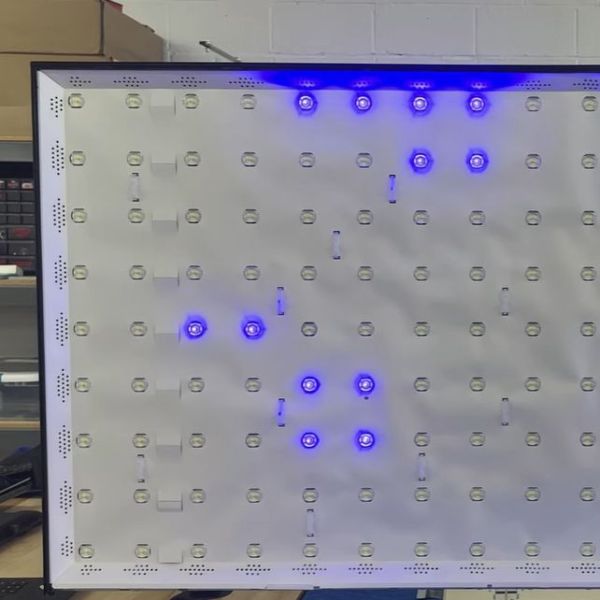

For the past two-and-half years Canadian consumer testing outfit RTINGS has been running an accelerated aging experiment across a large number of TVs available to a North-American audience. In their most recent update, we not only  find out about the latest casualties, but also the impending end of the experiment after 18,000 hours — as the TVs are currently failing left and right as they accelerate up the ascending ramp of the bathtub curve.
Some of these LEDs are dead, others are just wired in series. (Credit: RTINGS.com)
The dumbest failure type has to be the TVs (such as the Sony X90J) where the failure of a single dead backlight LED causes the whole TV to stop working along with series-wired LED backlights where one dead LED takes out a whole strip or zone. Other failures include degrading lightguides much as with our last update coverage last year, which was when edge-lit TVs were keeling over due to overheating issues.
Detailed updates can be found on the constantly updating log for the experiment, such as on the failed quantum dot diffusor plate in a TCL QLED TV, as the quantum dots have degraded to the point of green being completely missing. Although some OLEDs are still among the ‘living’, they’re showing severe degradation – as pictured above – after what would be the equivalent of ten years of typical usage.

  5. As the “electronics guy” in my village, my neighbors entrust me with their televisions when they break down. They usually buy a new one, a bigger one, of course.
    I’ve already been given eight televisions, and six of them failed due to a single backlight LED… the other two are waiting to be diagnosed and repaired, but I expect the same problem.
    I never need a screen that big, so when they’re repaired, I give them to someone who can’t afford to buy one. I’m usually given a bottle of wine or some good food without asking. Bonus: the TV does not end in a landfill…
    The funny thing is, the TV I use is much smaller than the one I repair (it’s a 24-inch computer monitor).
    How can customers afford to buy a new TV every two or three years, how can they accept such a scrap… It’s a mistery to me …
  6. one dead LED takes out a whole strip or zone.
    If one diode dies, you have to replace the entire backlight anyways. If you replace the one LED, it will be different from all the rest due to age, use, and manufacture (binning), so what difference does it make if the entire strip dies at once?
    If you “fix” it, you’ll simply get a brighter spot of slightly different color where you put in the new diode.

      1. The trick is to find somebody who does this more for the “fun” factor rather than the profit factor. I’ve got a guy, and he just gave me several big panel HDTVs (in good working condition) for my home for $40 and some beer, just to get them out of his basement.
      2. They are not hard to fix backlights, I’ve fixed about 6 of them. I find them for free, just solder on a few SMD leds (1c apiece, most TVs use pretty much the same ones, check if 3v or 6v, use low temp solder), little super glue to glue lens, costs less than a dollar total. In my experience, usually 2-4 leds are bad, but depends on model. Worst case, buy a led strip replacement. Took me about an hour first time. Not the perfect picture quality compared to new strips (usually ~$20), but plenty fine for me. Want your TV to last longer? Don’t run it at 100% backlight.
        1. It didn’t used to be as difficult, but cost reduction has meant the panel now sits directly on the bezel attached by a few dozen clips and the ribbon cables may also be clipped to it, you are forced to unclip that and breakage is more like 50% now. I used to do it all the time, but lately 🤷🏼‍♂️. And that’s if the 4GB NAND chip holding the TV OS isn’t borked, good luck replacing that and finding the image to flash back on there.
