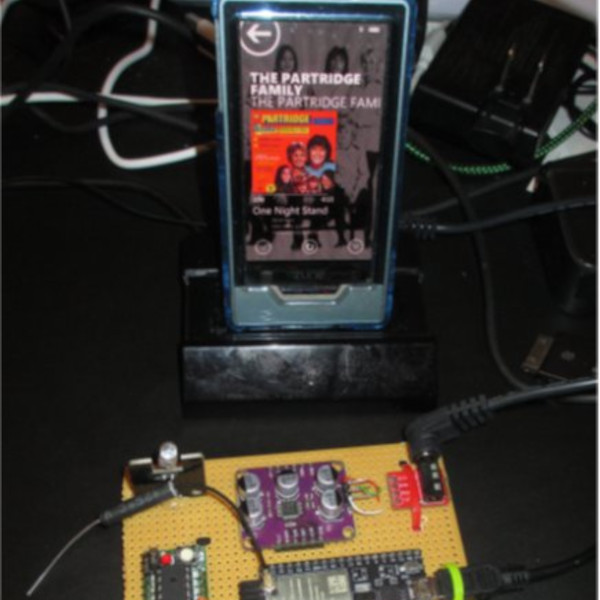

As far as media players go, there’s still some solid reasons to rock a Zune. Compared to other devices of the era, it offers a better DAC, an FM tuner, and no iTunes reliance. The goal of this project was to bring a bit of modern functionality without having to do any modification of the Zune itself. As the player supported docks with IR remotes, this build involves using an ESP32 to listen to the Bluetooth signal coming from the speakers, interpret any button presses, and forward them along to the Zune’s dock.

  2. Maybe I’m just dense, but I didn’t see anything in the article about how the bluetooth audio functionality was implemented. From the link, the Zune is placed in an ir-remote-equipped dock whose audio output goes (via an i2s adc) to an esp32 programmed as an avrcp-capable (think button-presses) bluetooth transmitter synced to a bluetooth speaker with navigation buttons. The speaker’s navigation button-presses (play/pause, skip F/R, and volume) are intercepted by the esp32, which then sends navigation commands to an arduino equipped with ir-transmitter/ir-receiver circuits. The ir-receiver circuit is used to program the arduino with the original dock remote’s signals, then the arduino uses the ir-transmitter circuit to replay those signals when the BT speaker’s buttons are pressed, with the ir led pointed at the dock’s ir receiver to complete the control loop, so that when buttons on the speaker are pressed, the zune responds accordingly. It’s definitely an interesting way to solve the puzzle, and the fact that it’s non-invasive (and therefore reversible) is meaningful, especially when using vintage hardware like the zune. I’d probably have shoved the whole circuit into the dock itself (and leave out the 4 added buttons and display which seem to be for future upgrades), but for the fact that this setup actually allows swapping input sources, especially if the alternate input sources have ir-remote capability. The whole project seems to be a pretty good example for someone wanting to add bluetooth functionality to vintage equipment, as well as enabling use of the bluetooth device’s remote buttons with the source.

  3. Wouldn’t it all work just on ESP32? The second MCU just sends the IR ESP easily can do this effort. 9 components listed, you only need an ESP32, a plug, an ADC and an infrared emitter. Heck, the Zune HD has an optical output, so you don’t really need a headphone jack and an ADC.
    1. Yes, it could all be combined eventually. In the writeup, I mentioned that the library I used for the ir was not compatible with the ESP32. I decided to just offload to an arduino since another ir library i tried didn’t work and so I went for the project finish. As for the optical, that can be part of version 2, with an s/pdif to i2s for the TOSLINK. I appreciate the comments.
