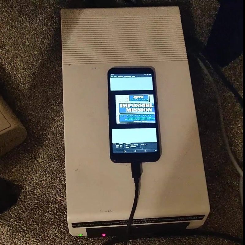

It all started with a sarcastic comment right here on Hackaday.com: ” How many phones do you know that sport a 5 and 1/4 inch diskette drive?” — and [Paul Sanja] took that personally, or at least thought “Challenge accepted” because he immediately hooked an old Commodore floppy drive to his somewhat-less-old smartphone.
The argument started over UNIX file directories, in a post about Redox OS on smartphones— which was a [Paul Sajna] hack as well. [Paul] had everything he needed to pick up the gauntlet, and evidently did so promptly. The drive is a classic Commodore 1541, which means you’ll want to watch the demo video at 2x speed or better. (If you thought loading times felt slow in the old days, they’re positively glacial by modern standards.) The old floppy drive is plugged into a Google Pixel 3 running Postmarket OS. Sure, you could do this on Android, but a fully open Linux system is obviously the hacker’s choice. As a bonus, it makes the whole endeavor almost trivial.
Between the seven-year-old phone and the forty-year-old disk drive is an Arduino Pro Micro, configured with the XUM1541 firmware by [OpenBCM] to act as a translator. On the phone, the VICE emulator pretends to be a C64, and successfully loads Impossible Mission from an original disk. Arguably, the phone doesn’t “sport” the disk drive–if anything, it’s the other way around, given the size difference–but we think [Paul Sajna] has proven the point regardless. Bravo, [Paul].
