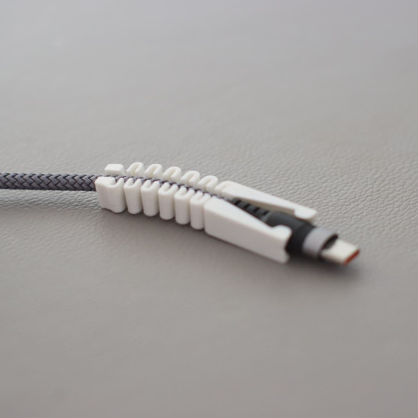

USB-C as the “One Cable To Rule Them All” has certainly been a success. While USB-A is still around for now, most of us have breathed a hefty sigh of relief with the passing of micro-USB and the several display and power standards it replaces. It’s not without its minor issues though. One of them is that it’s as susceptible as any other cable to a bit of strain. For that, we think [NordcaForm]’s 3D-printed USB-C cable strain relief is definitely a cut above the rest.
Waxing lyrical about a simple 3D printed model might seem overkill for Hackaday, and it’s true, it’s not something we do often, but as Hackaday writers travel around with plenty of USB-C connected peripherals, we like the design of this one. It’s flexible enough to be useful without resorting to exotic filaments, and since it’s available in a few different forms with curved or straight edges, we think it can find a place in many a cable setup. Certainly more of an everyday carry than a previously featured 3D print. If you want to learn more about USB C, we have a whole series of posts for you to binge read.
If it was a way to make right angle short ends, but it’s a way to put a longer lever into the poor socket which is much harder to replace. The right way to strain relief of a cord is a radiused funnel not that springy elephant trunk stuff. Besides aren’t those ugly soiled stiff braided cable sheaths better at holding up to stress?
I use a 90 degree adapter then use gaffer duct tape to support the remaining cable… This works well on stage for my electronics 👍😎
I’m pretty sure strain relief on this is less from single hard events that break the cable and could break the socket and more fatigue repeated small strains like you might expect from daily use on a mobile device. The latter probably isn’t breaking the port.
I think I skip this one, since I prefer a cheap but broken cable over an expensive repair to a broken connector inside a device.
You can use this before the cable begings to get damage.

I think their point was that it’s a bad idea to attach a big lever to the connector, so when something bumps it, instead of damaging the cable, it would wrench the USB socket off.

A spring type would looks more elegant

Jan, that thing won’t help against a yank the cable can’t handle by itself – unless your cables are the worst kind. Mind, it’s not about price, it’s about build quality. And yes, I have destroyed both cables and displays by mis-abusing them or accidents. I have also thrown out bad cables right after opening the box.

To be honest this would also relieve strain to the socket itself. Take for instance, plugging in your phone and watching videos landscape. The weight of the wire itself is weighing down on the port. With this, you’re essentially shifting the center of gravity so it wouldn’t be as much strain.
That is not how that works. All you’re doing is adding more weight at the socket, with this attached. (I don’t find that USB cables are heavy enough that downward force on the socket when mounted horizontally is any kind of issue anyway, but this will marginally add to, not lessen, that force.)
If you’re YANKING on the cable, then sure, this may reduce the amount of force transferred to the socket. Nothing to do with gravity or its center, but it might lessen some of the force. Enough to matter? Doubt it, but who knows? The more reliable solution is not to yank on your cables, especially not with the socket in your phone.

Yeah, let’s just put more leverage on the cable so the socket on the expensive device gets broken instead.
