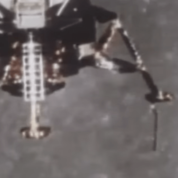

The LEM was amazing for many reasons, but as [Apollo11Space] points out, the legs were a particularly thorny engineering problem. They had to land on mostly unknown terrain, stay upright, allow for the ascent module to take off again, and, of course, not weigh down the tiny spaceship. They also had to survive the blast of the LEM’s engine.

The video shows how many options were on the table, but the four-legged splayed footprint design was the winner. A Canadian company was instrumental in the successful production of the legs. One interesting thing is that the legs had a one-shot aluminum honeycomb shock absorber that destroyed itself as it absorbed the impact of landing.
It offers a fascinating glimpse into how it must have been to design something for the unknown, which couldn’t be properly tested until it was actually used. It was also fun to see the giant gantry they used to simulate lunar gravity for the test articles (that didn’t look much like the real thing, by the way).

“They also had to survive the blast of the LEM’s engine.” Gonna have to ask for more detail on that.
“allow for the ascent module to take off again” Other than just being there, how did they “allow” that? This sounds like a Physics 101 error I’ve seen before, the idea that rockets at whatever altitude push against the ground.
If one or more LEM legs are destroyed by the rocket exhaust while they are still supporting the Ascent Stage, things might go .. sideways.
And the rocket exhaust points at the legs because….. ?
The rocket exhaust points at the ground, which deflects it (and a large amount of abrasive moon dust/rocks/debris) sideways against the legs of the Lunar Module.
Two parts to that – first the engine used on decent to slow the craft. It’s just a big thruster, and the legs need to not be damaged by it.
Subsequently, the thrusters that yeet the capsule back into lunar orbit – these honestly just need a clear exhaust path.
