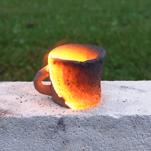

A clay mug is placed on a fire brick. Portions of the mug are glowing orange hot, and the heat is spreading across the surface. Some portions of the mug have cooled, and the heat has not reached other parts.
Finely powdered aluminium can make almost anything more pyrotechnically interesting, from fireworks to machine shop cleanups – even ceramics, as [Degree of Freedom] discovered. He was experimenting with mixing aluminium powder with various other substances to see whether they could make a thermite-like combination, and found that he could shape a paste of aluminium powder and clay into a form, dry it, and ignite it. After burning, it left behind a hard ceramic material.
[Degree of Freedom] was naturally interested in the possibilities of self-firing clay, so he ran a series of experiments to optimize the composition, and found that a mixture of three parts of aluminium to five parts clay by volume worked best. However, he noticed that bubbles of hydrogen were forming under the surface of the clay, which could cause cracks during the firing. The aluminium was reacting with water to form the bubbles, somewhat like a unwanted form of aerated concrete, and for some reason the kaolinite in clay seemed to accelerate the reaction. Trying to passivate the aluminium by heating it in air or water didn’t prevent the reaction, but [Degree of Freedom] did find that clay extracted from the dirt in his back yard didn’t accelerate it as kaolinite did, and the mixture could dry out without forming bubbles.
This mixture wasn’t totally reliable, so to make it a bit more consistent [Degree of Freedom] added some iron oxide to accelerate the burn through an actual thermite reaction – some mixtures burned hot enough to start to melt the clay. After many tests, he found that sixteen parts clay, seven parts aluminium, and five parts iron oxide gave the best results. He fired two cups made of the mixture, a thin rod, and a cube, with mixed results. The clay expanded a bit during firing, which sometimes produced a rough finish, cracking, and fragility, but in some cases it was surprisingly strong.
The actual chemistry at work in the clay-aluminium mixtures is a bit obscure, but not all thermite reactions need to involve iron oxide, so there might have been some thermite component even in the earlier mixtures. If you need heat rather than ceramic, we’ve also seen a moldable thermite paste extruded from a 3D printer.

  1. Put a tray of water next to the plastic bag, and invert a jar in the water. Run a tube from the ziplock bag to the jar so that the gas from the ziplock bag is captured, and now you have something that can be tested.
    Put a smouldering match in the jar, and if it catches fire then the gas is probably oxygen. Put a lit match into the jar, and if it goes out it’s probably CO2. Bubble the gas through lime water, if it turns milky the gas is CO2. If the gas goes pop when a lit match is used, it’s probably Hydrogen. Ammonia and Chlorine can be detected by smell, neither is particularly dangerous in small diluted amounts (open the jar away from your nose and gently waft the contents towards you).
    If you know what gas is being generated, it will help you pin down the reaction.

      1. Claude says the aluminum is reacting the silica (SiO3) in the clay, and explanation sounds plausible to be. I guess that shows how bad the village idiot ChatGPT is.
        1. Silicon oxides and aluminum are a thermite mixture – which is how the self-firing clay works in the first place – and the water can catalyze the reaction alone or in the presence of other impurities. The reaction would continue until the water is driven off. The gas that develops is mostly going to be steam.
          If that is the case, then forming the clay with the aluminium using some other solvent or binder should work better. The solvent cannot be ethanol, methanol, or isopropanol since those would attack the aluminium. Acetone should work and dry up completely.
          Another alternative is to use minimal amounts of water to limit the reaction and pressing the damp powder into shape in a form.
    2. That analysis might be possible, but thermite reactions produce solid and liquid products, so any gasses that are produced would probably only be side products. My main guesses were that the aluminium might be reacting with hydroxides and hydrates to release hydrogen, which would be what actually burns in the flame, or that the aluminium might be reducing silicates, as described by

  3. I’m pretty sure water is a problem. In ceramics, a clay object is put in a drying room for a couple days to a week? Someone from a Univ. ceramics department will chime in I hope. The the kind of leather clay can be trimmed and adjusted and handles added with slip for glue. Then it can be low fired to bisque, which is porous, and glazed if wanted. Some things are low fired after this with low temperature glazes. The kaolin types are high-fired as high as “cone 10” for vitrification and the high temperature glass effects. I probably have this inaccurate in places. The point is that the drying process is long and multi-stepped.
    The burning reaction look at hot as cone-10, almost 2400 deg F / 1300 C. Hot enough that can not see anything inside a kiln because it is close to be a black body radiator and everything inside is emitting the same spectrum. The question is, does it take time to get vitrification?
  4. Kaolinite clay is might be considered a mix of aluminum oxide, Al2O3, and silica, SiO2 (really, Al2Si2O5(OH)4). The thermite (Goldschmidt) reaction depends on heat released when aluminum powder steals oxygen from something else, yielding aluminum oxide. Obviously, it’s not from the Al2O3, which is already the end product, but the silica (and iron oxide) provide the oxygen.
    Perhaps adding more silica to the kaolinite, rather than iron oxide, might produce a more durable product. You might also experiment with other comparatively low-melting oxides, such as Bi2O3, to see if that helps reduce cracking.
